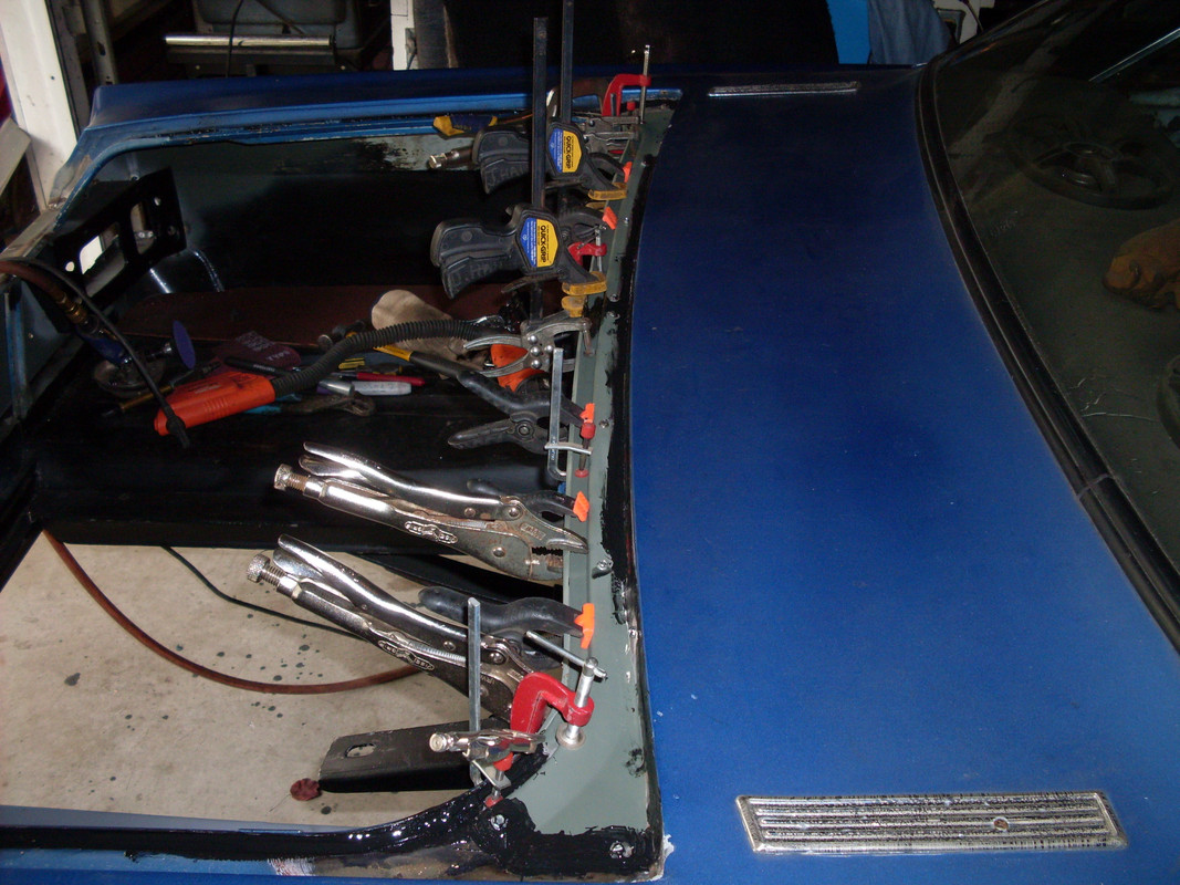

Okay, perhaps my brain has been stagnated by a Falcon.
Ya wanna buy some clamps?

I think you're talking to me I threw the entire fleet at gluing that trunk gutter on & still had to use some visegrips . but I guess you noticed thatLip Ripper wrote:
