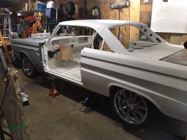

Here is a picture!

A better pic of the whole car, after getting my new wheels

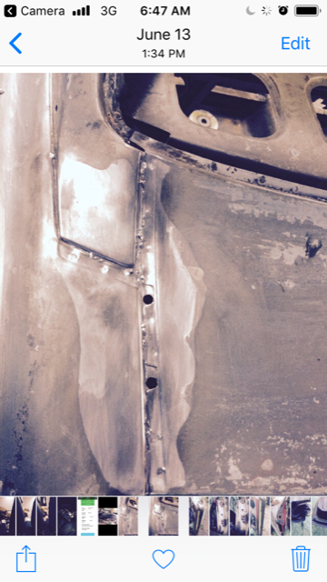

I brought my Comet back to the paint shop and requested they remove the original lead. I decided to do both sides even though only one side had an issue. I took my chances welding it.

This was the original picture before starting the process and the prior post was after being welded and it's an image of the weld from the inside underneath the headliner.

Ya those spots, there and at the bottom where the panel meets the body and in front of the trunk seem to be the weak spots in these cars.
