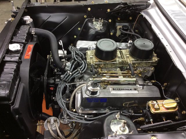

My newly purchased 1965 Cyclone A code has an aluminum intake with Cobra cast into the front of it and two Edelbrock four barrel carbs. No vacuum secondaries and no choke assemblies. I haven't driven it much but it seems to start, run and drive fine so far. Does anyone know what this is?
Re: Dual fours on my Cyclone
The intake could be an original Cobra manifold from the ‘60’s or it could be a newer reproduction, if you remove it and it has “Buddy Bar” cast into the bottom it is a ‘60’s original, Buddy Bar foundry did all the casting for FoMoCo and Shelby back then. Either way it is an over the counter manifold, Ford did not offer an AFB (Edelbrock) style carb, they used Holley’s, the flange bolt pattern is different between the two. The AFB style carb is a reliable carb, most guys who cannot dial in a Holley resort to using them.DesertRat wrote: ↑Sat May 02, 2020 8:29 pmMy newly purchased 1965 Cyclone A code has an aluminum intake with Cobra cast into the front of it and two Edelbrock four barrel carbs. No vacuum secondaries and no choke assemblies. I haven't driven it much but it seems to start, run and drive fine so far. Does anyone know what this is?

Thanks! I thought could be the case. I am guessing it is a newer reproduction. I can tune Edelbrock carburetors but I have never owned a dual setup. I am sure that I wont leave it that way. I'll go back to a single 4V.A/FX wrote: ↑Sat May 02, 2020 8:41 pmThe intake could be an original Cobra manifold from the ‘60’s or it could be a newer reproduction, if you remove it and it has “Buddy Bar” cast into the bottom it is a ‘60’s original, Buddy Bar foundry did all the casting for FoMoCo and Shelby back then. Either way it is an over the counter manifold, Ford did not offer an AFB (Edelbrock) style carb, they used Holley’s, the flange bolt pattern is different between the two. The AFB style carb is a reliable carb, most guys who cannot dial in a Holley resort to using them.DesertRat wrote: ↑Sat May 02, 2020 8:29 pmMy newly purchased 1965 Cyclone A code has an aluminum intake with Cobra cast into the front of it and two Edelbrock four barrel carbs. No vacuum secondaries and no choke assemblies. I haven't driven it much but it seems to start, run and drive fine so far. Does anyone know what this is?

I would try to keep the duals, the wow factor is so much better than a single carb. I have run tri power, singles, and now dual Holley’s, it takes some fiddling but the results are worth it.DesertRat wrote: ↑Sat May 02, 2020 9:13 pmThanks! I thought could be the case. I am guessing it is a newer reproduction. I can tune Edelbrock carburetors but I have never owned a dual setup. I am sure that I wont leave it that way. I'll go back to a single 4V.A/FX wrote: ↑Sat May 02, 2020 8:41 pmThe intake could be an original Cobra manifold from the ‘60’s or it could be a newer reproduction, if you remove it and it has “Buddy Bar” cast into the bottom it is a ‘60’s original, Buddy Bar foundry did all the casting for FoMoCo and Shelby back then. Either way it is an over the counter manifold, Ford did not offer an AFB (Edelbrock) style carb, they used Holley’s, the flange bolt pattern is different between the two. The AFB style carb is a reliable carb, most guys who cannot dial in a Holley resort to using them.DesertRat wrote: ↑Sat May 02, 2020 8:29 pmMy newly purchased 1965 Cyclone A code has an aluminum intake with Cobra cast into the front of it and two Edelbrock four barrel carbs. No vacuum secondaries and no choke assemblies. I haven't driven it much but it seems to start, run and drive fine so far. Does anyone know what this is?

My first 65 Cyclone had a 289 with a moderate cam. Don't remember the specs on it now, but it had a bit of a lope at idle. It also had dual 4V Holleys. I had the linkage set up to run on the front two barrels of front carb to half-throttle, then the other six barrels rolled in together. It was fun to drive. Like Jim said, the dual carbs definitely presented a wow factor when the hood went up in a crowd. My current 65 with a 302 has a single 500 cfm Edelbrock, which serves me just fine, but if I had a dual 4V, I'd have to keep it.

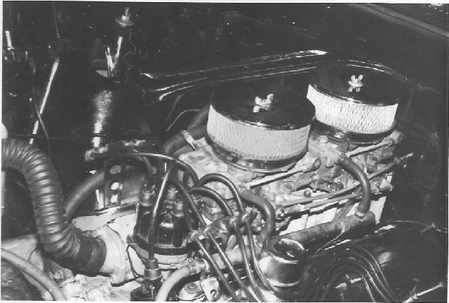

Back in 95 or 96,I installed dual 500 edelbrocks..edel,performer rpm cam ,the carbs have a manual cchoke,which I wired open right out of the box,,,I ganged them together,,it starts idels off both ,,works great...also put in a pete Jackson gear drive,,,I never have to touch it,,have put many miles on this 289,,still drive it today,,put about 50 miles on it today !! I am so impressed with it that the cobra replica me and son are now buiding,has a 65 289,with edelbrock alumn heads,2 500 carbs and a edelbrock ACU-DRIVE gear drive ,performer rpm cam.....the only draw back to the edelbrock carbs if it sits for a few days ,,motor will have to crank over a few times to pick it's prime back up..other then that their OK...start it everyday or 3 and they seem fine.....2 4's are way better to look at then just a single carb set up.....do what you want to ,it's yours,,,but I'd leave it as is,,,good luck....pop.....that wow factor is hard to beat on an old car...……..

dual fours ARE impressive,Eds not quite as much as Holleys.The Eds are probably drilled for square bore and Holleys will probably fit if you're so inclined.
