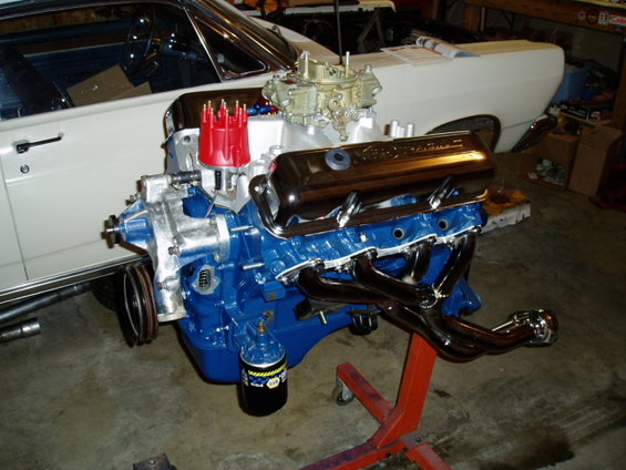

I love my FPA's. The others all drag the pavement. And if you're running the GT heads you need the headers made for them. They are not cheap but they are great. Here is a clip I made after installing mine.

The fit is very very good. I did have to take the cut off wheel and cut a very small relief on the side of one torque box flange. You know, the little wings that stick out to the side on the bottom. Nothing structural. I am running the C6. I have read that it is easier to install them on the engine then drop it in. They hug the engine that tight. I just looked and I don't have any pictures of them in the car. It would be hard to see them anyway.

Thanks. I do have a set of the stock GT exh and the 428 cj exh just never liked how the tube headers hung down so low as my car is very low. Now I'm considering the FPA headers. :D

I have FPA's in my 1966 Fairlane/390 (similar to 1966=-67 Comets). The FPA's fit nice except the heat will get to the power steering boot if you have power steering. I used the drop bracket and made a 5/8" spacer and still melted the boot. Since I like my headers more than power steering I changed over to manual steering. My car was originally a C6 and the headers fit great. In 2008 I switched to a toploader 4 speed with a Lakewood scattershield and they FPA's still fit great. I use a OEM starter as well. They were designed to fit OEM starters but sometimes you'll find one that is a little big. I bought one from NAPA and it was a bit too big. Had my original starter rebuilt and fits like a charm.
And the drop bracket and spacer I later removed.
