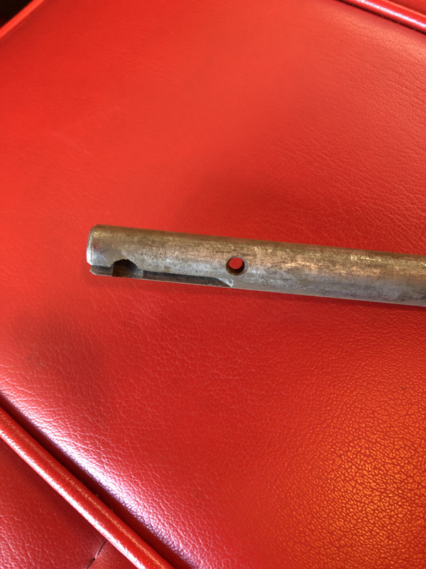

Parking brake cable came in couple days ago. Wife and I have been under the weather all week. Haven't felt up to getting under the car yet to pull the parking brake housing to rebuild. Have found all the parts I need and did a deep dive into getting it all together while resting a bit.
Everything except one item. Need the pin with the button head that presses into the rod (see pic below). It limits total travel and keeps the rod from being jammed into the cable pulley. Pretty sure this is why my pulley is pinched and is getting replaced (thanks, Jim). Does anyone have a source or know the size for this one? I can't find any information on this anywhere, been looking for days. Think I'll take the rod to Ace when I'm up to it and try to find something that fits to get size. Thanks to all

If you can’t find a pin to fit I would think about threading that hole for a button head screw and assemble with a tiny bit of loctite.

May be my only recourse, Pat. A very good neighbor works @ Ace and knows the entire store stock off the top of his head.
He may be able to fix me up, @ least get proper size, maybe a pin.
Need something like this- https://www.mcmaster.com/products/door- ... owel-pins/
The rod D= 1/2", hole D approx. 0.175". Need the H & D for the button head.
Thanks

Problems solved.
All it takes is a call to Secret Agent Man!
