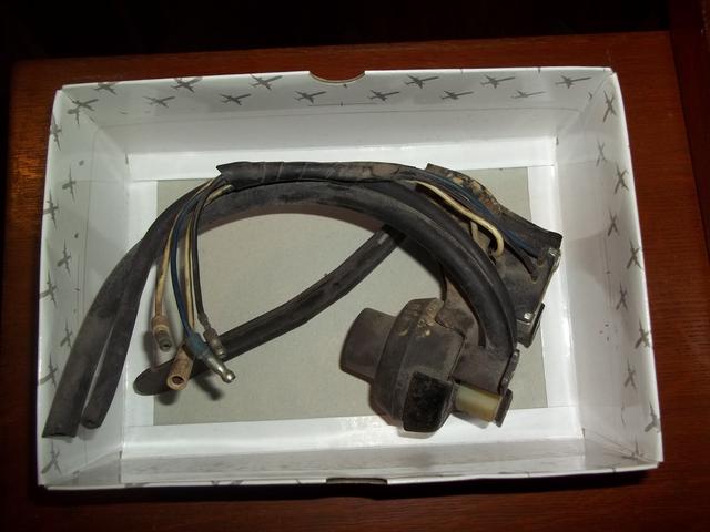

I found some guys who have some of these 70s trucks wiper set ups. 2 from a guy ,50 each,without motors,but he is out of motors. would like to get a 2 speed motor for my comet from the same person & my 76 truck wants one of the delay switch kits. I was riding the truck in the drizzling rain yesterday & got the idea I want a foot pump with wiper swipe switch like Barry mentioned in my truck .the one in my comet is great on those days when your wipers drive you nuts with the loud dry scrub! :x here is my spare pedal,, I was about to offer up for sale but changed my mind & its going in the truck. :lol:
& to help explain what Barry said, in this pic you can see the button on the switch pops out when you push the pedal part way,buy as you can see it it not yet depressing on the rubber pump bulp. And as an added feature you can stomp the pedal & shoot washer fluid over the car on to any tailgaters who may be too close. :lol: :lol: you might have to adjust your squirters just a little , but I know it works,over 50 years ago I was squirting women on their way to the outhouse at church &I was hiding down in the seat & stompin that pedal. they thought it was raining :lol: :lol: :twisted: :lol: :roll: :P

poboyjo65 wrote:he one in my comet is great on those days when your wipers drive you nuts with the loud dry scrub!
You have a picture of the one in your Comet?

Posts: 7059
Re: '65 Wiper Switch/Systems: Two speed = interval?
Yea here is a pretty good one,,,, it's just like the one in the pics I posted but has the rubber pad that this one is missing.
