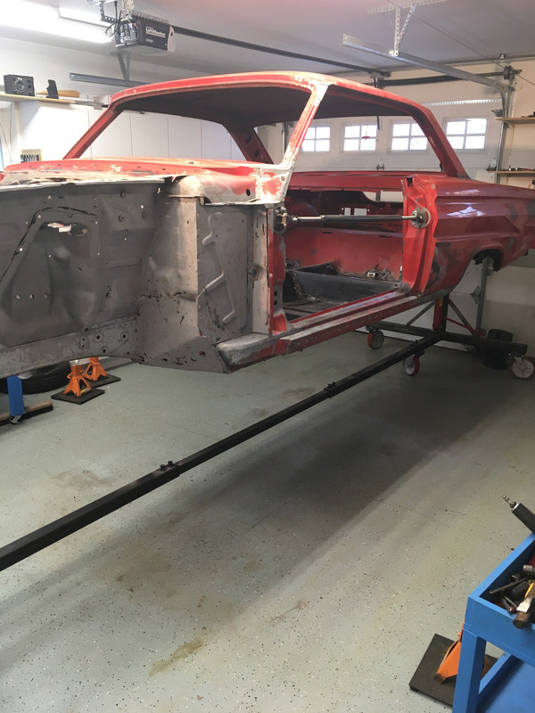

I have a lot of work done on my car. I want to start posting the build but I seem to be photo disabled.
When I can repeat posting photos I will start the actual build thread with the beginning photos.

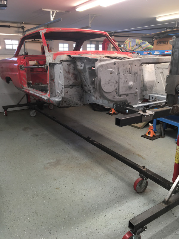

Thanks for asking. I have extensive photographic documentation of every step of this build. The problem is I am apparently too stupid to navigate the photo protocol on this site. I want to start the build thread but every time I try I cannot get the photos to post.
To answer your question I ordered the mustang mounting kit with the rotisserie. This attaches at the rear spring frame sockets in the rear and the front bumper brackets in the front. Since I ordered the mustang mounting kit I have two extra brackets. I have fabricated two rear bumper bracket mounts and this weekend I will modify my two extra mounts and change the rear rotisserie mount to the bumper bracket mounts. I need to free up the suspension sockets so I can install my rear suspension complete while the car is on the rotisserie. I ordered the 8" casters with the rotisserie so I can roll the entire setup out to my driveway for sanding and body work and back into the garage during the cold weather. My garage is standard height and I have lots of room vertically but it is snug lengthwise. It all fits though------------- :D

The rotisserie is 18'5" overall in my garage.
This is the car in the rotisserie in my garage. It looks like I will be able to post photos so I will
show how I got here in my build thread just started in 64/65 comets.
Cheers----------DR
