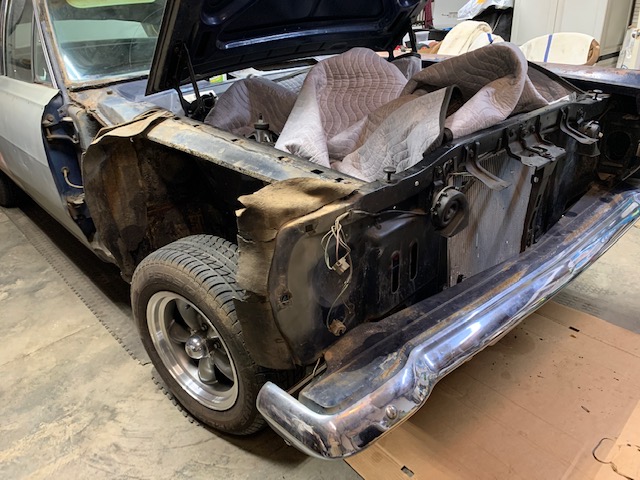

You release hook is probably catching, try to look under the hood, maybe you can see the “J” type hook that might be catching the small bar.
Maybe this might help understand where the hood latch might be catching. See the middle bracket on the radiator support.
Another pic of the center catch bar.
