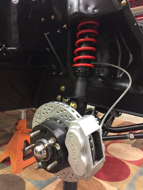

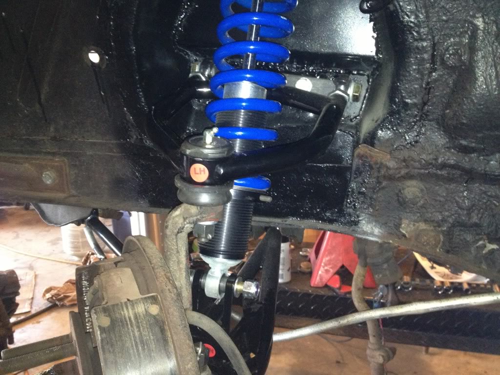

I installed Viking coil over shocks in my triangulated 4 link in the back and the car road so nice I wanted to do something in the front. I found that Viking made a set of coil over shocks for the front also so I installed them. The shocks are double adjustable for ride comfort or race mode and you can set the ride height of your car. They bolt right in place of your existing coil spring and shock. I like them. Tom

I put on the street or track coil overs in my Cyclone. Shaun lives just North of Detroit and I just drove to his house to get them. Been on my car for over 10 years. Like them so much I put them on my 66 Fastback too.
