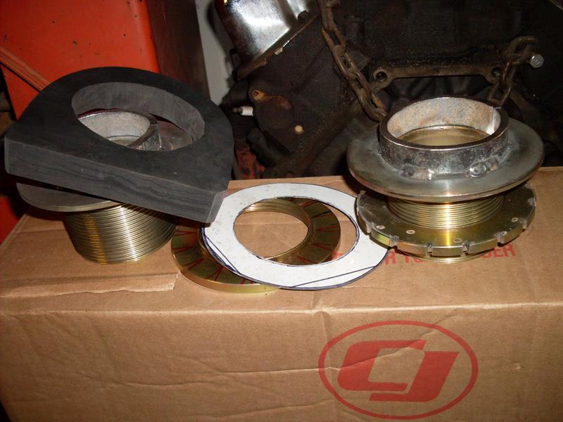

Andy mine was way too low with 1 coil cut from new coils so I made a 1'' rubber spacer & adjustable spacers .got it where I wanted & could still go up another 1 -1 1/2 inch or more on the spacer,dont know how high that would end up but plenty of ajustment that way & I could go back down too. good to be able to change it because now I'm going with taller back tires & new leafs soon, so I can raise the front easy to make it match the change in the rear.
I got them from speed way, ;
https://www.speedwaymotors.com/AFCO-Adj ... 49203.html
altered them to suit me;

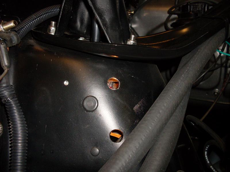

I put notches in them so I could reach thru the holes in the towers to turn them with a big screw driver,kinda like adjusting brake shoes;
It was a little extra work but not too bad. but I'm glad I did it like I did. all I have to do is jack it up & get the weight off & whip out the big screw driver. I may even make a better tool with a tad of a bend in it so it doesn't slip off as bad.

Those coil spring spacers are pretty slick. Could have sold millions of them in the 60's,early 70's. As slick as they are,my vote is coil overs.You would still be rolling the dice on the spring weight but you would have much more adjustment.
Posts: 2764
Re: Coil Spring Dilemma
The spring rate, measured in lbs/in, is a measure of "stiffness" of the spring. The higher the spring rate, the stiffer the spring, and it's a function of both the diameter of the spring material and the shape of the spring. Shortening the spring can actually increase the spring rate. So if the Crites spring was on the stiff side, shortening it will make it a little stiffer. If the Moog springs were OK on ride, but just sat too low, I'd recommend going back with them and install a set of adjustable spacers like John did in his car. The mods he made to his for easily adjusting them are a super idea and would allow you to easily dial in the height you want. And $80 for that kind of flexibility is a bargain.
