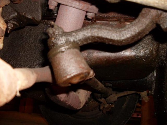

The problem is the steering linkage is right where the pipe needs to turn back. you might could fab something to work but most tube benders cant bend it sharp enough to go above the linkage & if you go below it'll be way low. So the mav one makes it easier. & if you have a stock clutch set up the z bar will interfere with the mav manifold. Comethead did this swap. I think he used a hipo stang z bar. maybe he'll chime in & tell you which one.

I used the Maverick left side manifold and 65 Mustang Hipo zbar which has the lower leg all the way inboard. Gave me enough room to get the exhaust pipe through there. Still tight though.
Mustang engine compartments are wider than the Comets so I had to cut off a small piece from the inner end of the zbar tube.
