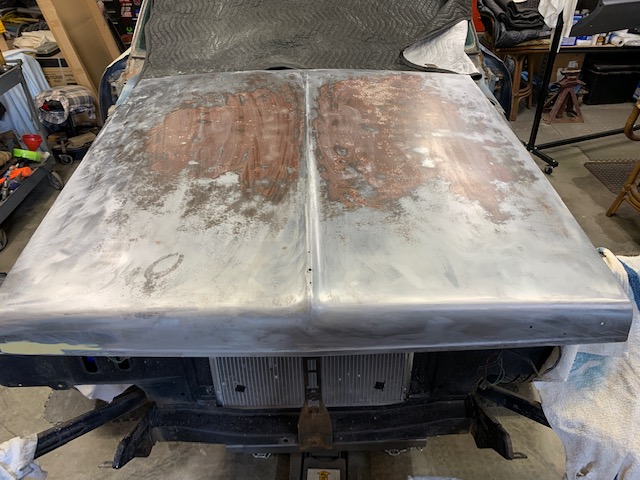

I’d like to get some feedback if possible on painting the hood on our 66 Comet. This will also carry over throughout the rest of the car, especially the roof and trunk area.
I’ve stripped down the hood, and put picklex20 on it, that stuff preserves it well. I want to epoxy prime but am concerned about what looks like rust embedded into the hood (see picture). I want to prime then body work the dents in it, prime again and go from there.
Any thoughts on priming over this as it is, or should I try sanding more, ospho, or something else. I’ll be doing this to the rest of the car as well.
Thanks for any feedback, I need to get back at this thing…..

Phosphate it and go from there.

You must remove the rust not cover it with any “miracle” product. The rust will go through the metal to the underside if you try to just treat it. Sand it, lightly blast it, or have it dipped, either way you cannot prime or paint over rust, unless the future of your efforts are not important.
I have learned this from decades of building cars. Do it right the first time and you will not have to worry about a second time.
Just my opinion.
Posts: 1664
Re: Fighting Rust
Agree with Jim, get rid of the rust.
I would DA the hood down wit 80 grit to bare metal then 2 coats of epoxy primer.
Sandblasting a hood can go bad quickly. If you do want to blast it you need to take it to someone who has experience with auto body panels.
If after you DA the hood there is still a littl rust you can blast it very lightly. Low pressure with nozzle a good foot away. Practice with some cardboard first. Adjust pressure and distance where you are just making the top of the cardboard fuzzy. If you are blasting thru the cardboard you will likely warp hood.
I think DA'ing with 80 to bare metal then 2 coats epoxy primer should do you well!

Thanks guys, I was thinking along the line of trying what Lou mentioned, to DA with 80, and see what it does. It’s like a deep seeded rust, but I’ll try first with the DA, if that doesn’t work, I’ll likely blast it as you guys mentioned.

Is it also rusted on the underneath of the hood same area??
Just a suggestion but I would start where the rust is the worse. Sand with DA,,, hit with stiff wire brush, sand blast, blow gun on air hose, etc.
Both sides of hood if other side is rusted too. This way if you get pin holes or rust-thru you find out before doing the whole hood. Instead of doing the bad rust last and find out you have holes after doing whole hood. Deep seated rust may produce some holes when taken off on sheet metal.

The underside isn’t bad, a bit of surface rust, but it’s pretty solid, still has original paint on the area below the bad spots on top.
Posts: 1216
Re: Fighting Rust
Is the rusty area under the hood above the battery tray? It looks like acid damage that ate the paint away then rusted.
Posts: 569
Re: Fighting Rust
Wed Jun 19, 2024 8:28 pm
You nailed it Jim 👍
