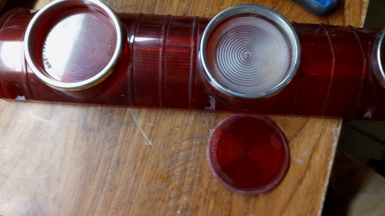

I removed all 3 chrome trim rings from the broken lense.
I will post pics and a drawing later. I used a heat gun to soften the lense and pryed the ring off. There is no glue it is a mechanical grip. The outside of the ring is curved under
and in production I think is pressed onto the lense with heat involved.
Overheating the lense is a problem, too hot the lense distorts, not hot enough the lense chiped where I pryed. The backup clear portion of the lense is more sensitive to heat and distorts quicker.
If the lense you want to put the ring on is really good with a bent ring I would cut the ring off rather than chance ruining it with heat. Pics to come.

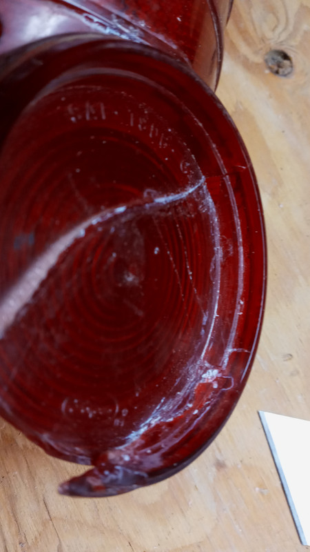

This broken lense was just what I needed discover how the trim rings were attached to the lense.
I used a heat gun to free the ring and then pry it off.
The crack was there but you can see how the heat distorted the edge of the crack.
On this ring mount I used less heat but the lense chiped easily when prying the ting off.
And the heat still distorted the lense a bit at the ridge on the rib.
This pic shows the retaining groove the ring rests in.
And here a drawing showing the ring cross section which convinces me it is pressed on in production, maybe with heat too.
The clear backup lense was even more susceptible to distortion from the heat. The clear lense is molded into the tailight in production and I wanted to see if I could remove it but not without destruction.

Cool thanks for the instructions, it looks like if you have a broken lens with good rings and a good taillight with bent rings you could get the good rings and cut the bad rings off and maybe end up with a good taillight. Have you tried reinstalling a ring yet?
Re: 64 taillight lenses
Well I sorta tried installing one. I pushed one back on and had a heck of a time to get it off again
Think I'll just use some good glue.

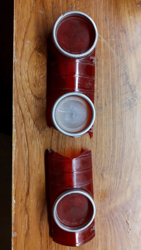

Got side tracked and never moved forward on the sequencial tailights.
Lately been playing with the garbage lense seeing what hacks would work on it.
Here are a couple that may save partially destroyed from being tossed.
They can be cut apart and glued together with invisible results.
This would be very beneficial if you had a taillight broken at the outter lense. Here I cut the lense off at the rib, sanded and glued back together with super glue. Left it over night. Have handled ths lense tons since trying other hacks, still together.
I didnt spend anytime cleaning it up but would be invisible if I did. The glued joint is up along the rib by the broken out piece.
I broke the piece out sawing it apart,,, careful they're brittle!
Sorry forgot before pics on these two hacks.
If a lense gets broke,, save the pieces!
Here I broke a piece out and glued it back in with super glue.
Very strong if you don't have another lense the rest of your cruising won't be put on hold till you find another lense.
I broke the bigger half of the lense out gluec it back in.

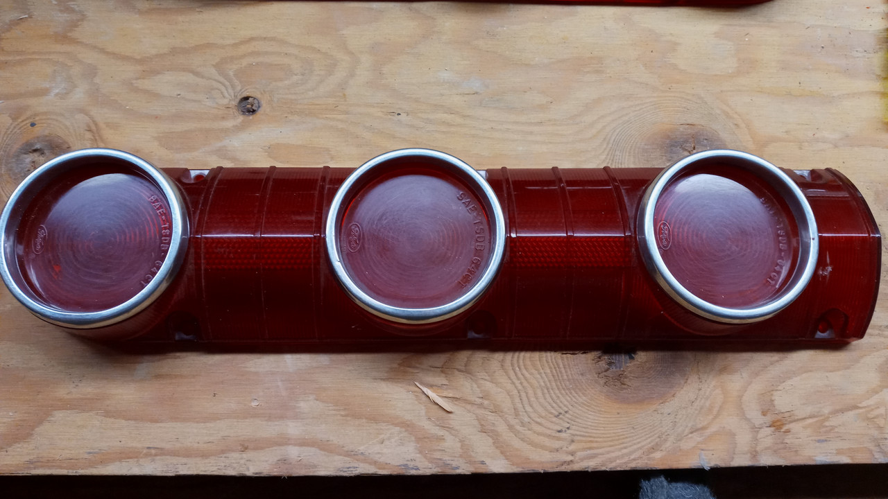

Settled on the two lenses Im going to use for my sequential taillights pionered by Mike.
I bought a pair of all red lenses from Redhotcomet but once I got looking at them I decided to only use one of them. After some "testing" I figured out how to modify a backup lense to an all red lense and change out trim rings.
The first three pics are the reset of the two pieces, removeal of backup lense and replacement of bent trim ring.
These two pics are before and after on the other lense.
A portion of the lense had a big crack which I didnt think I could get glue into effectively so I broke it off. This also loosened the trim ring enough to be removed. Under the trim ring some of the ring mounting area had broken away so I just used a bit of black RTV to resecure it.
I used super glue or same with different name on all the lense setting I did.,, theres a long name for this type of glue. The word starts with a C and continues on,,,,, for while.
