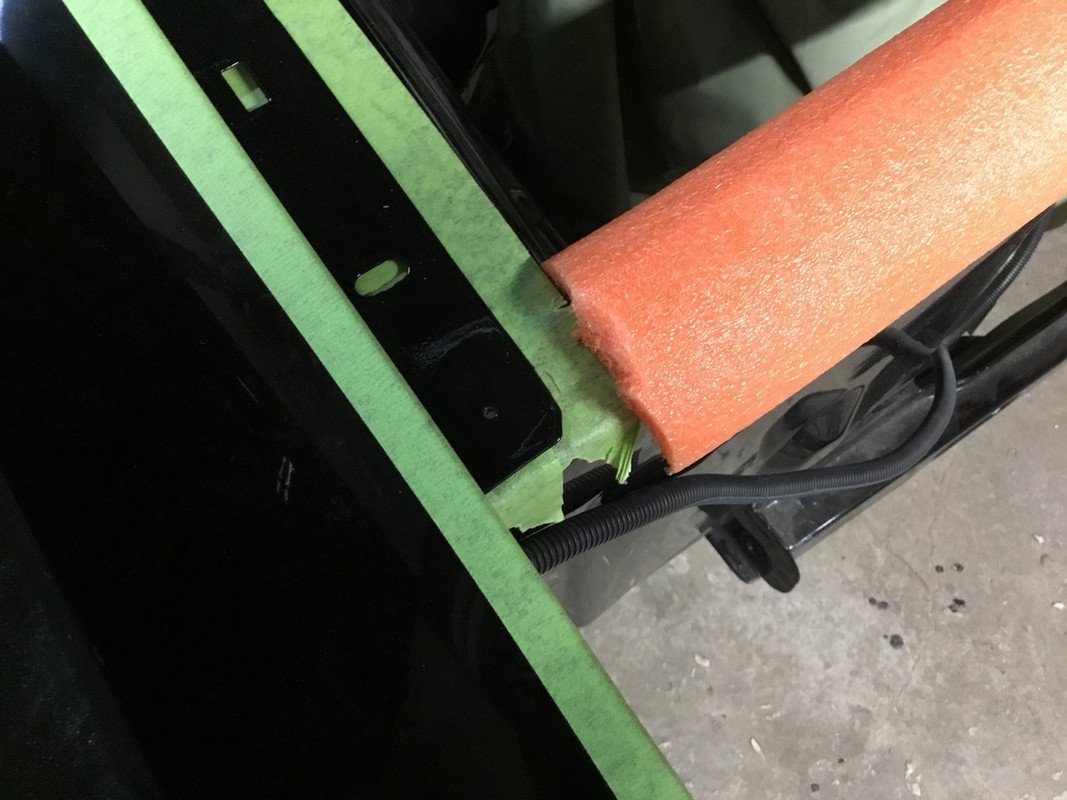

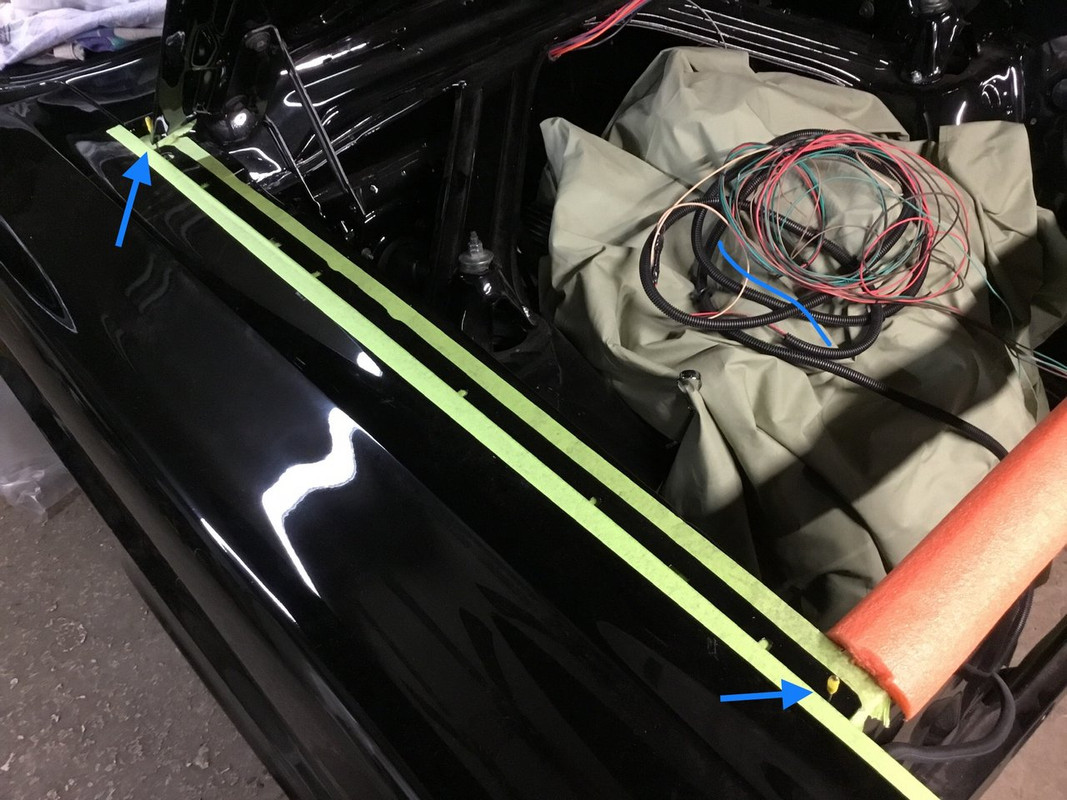

I just started reassembling my front sheet metal. Pins worked nice. Here is a picture of the pins lining up RF fender. I wrap the drill bits with masking tape (yellow) so they are easier to work with and they don't fall through.
Here is a picture of the hole for the pin, really not that noticeable
Put my fender right back where it was....happy face :)

Thanks for the pics Lou, makes a whole lot more sense to me now 👍 looks great. I know that’s going to be one fine Comet.
