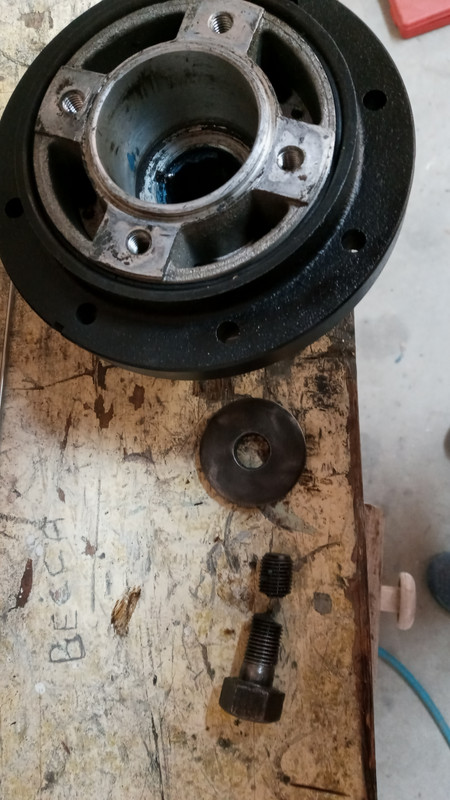

Started at the oil pan. There's a crack in a spot I welded so out it came but man what a fight! No gasket just sealant and stuck.
Had to resort to an air hammer with the chisel ground like a wood chisel and low air pressure, still bent the lip a bit.
Thought the front seal was toast but went to pull the balancer found this! Thank goodness the part in the crank wasn't tight.
At least the seal surface is fine.
After some investigative reading it was stated the bolt is a one time use item, I got off lucky it didnt hurt angthing else.

Yikes, Fred! :shock:

Wow Fred you sure dont waste any time getting started! & I'm still doing yardwork , house work, & even shop work. :roll:
Boy weird that it was loose up in there. big luck ! better go buy lotto tickets you're hot! :D Maybe it got loose & was partially backed out ? :?

Ya big happy it was loose!
