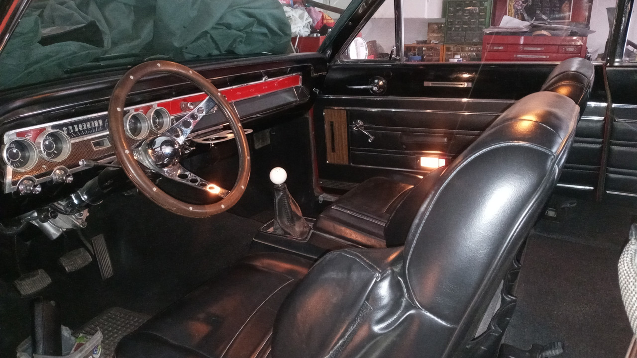

Wish I could drive it to test weather the the vibrations I thought were chassis problems were actually timing issues but I already posted this pic from 2 days ago elsewhere on the site.
When it warms up (record cold last night!) I may restart the console and stereo.

You fabricating your own console? Or got a factory one. A console has been floating around in my head for a while. Be nice to have a drink holder and a place to stash some stuff. Been thinking of building my own but need to get a lot of other stuff done before that happens.

I do have a decent stock one but same as you want more places for stuff plus a stereo maybe with a screen. Thinking maybe Fglass, vinyl wrap.
Maybe complete new or addition to stock. Lots of ideas floating but no solid plan.

I plan to run my T5 shifter through my coin tray like you did. Where did you get your boot? Is that a Falcon console lid?
The boot is the factory '89 XR7.
In Canada Ive seen both lids in Comets. This lid was on the console when I got the car and there was no reason to think it wasnt original.
I haven't had to opportunity to quiz owners as to build location of their car and not many console cars around.
It looks natural with the shifter coming up in that spot plus I dislike the original location anyway.
