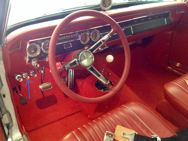

I have used a universal cable from NAPA for many applications.https://www.napaonline.com/en/p/BK_S672 ... KjcnBszQ8i
Sometimes the knob is threaded on and sometimes it is molded, I usually remove the knob then install a factory knob from the cigarette lighter in the choke cable end. For a trim washer I have used an original manual choke trim washer which is very rare or a washer from the headlight switch. (I machine off the “Headlight” logo then have the washer chromed)
The blue arrow points to the choke:
