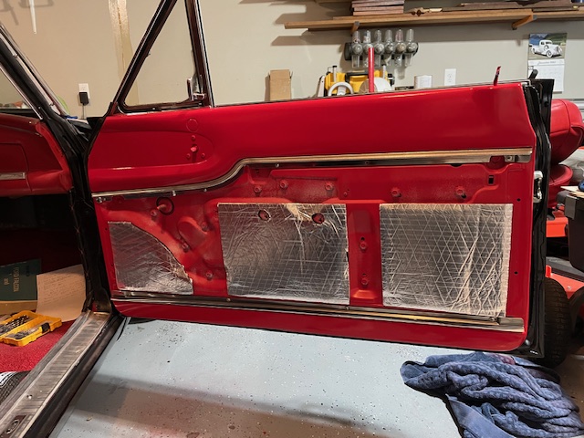

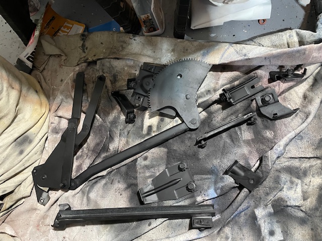

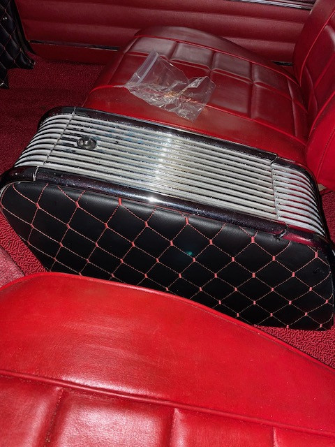

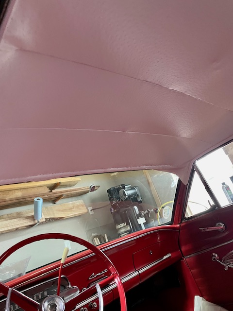

I made some progress on the interior (started before the main bearing caps cracked). I pulled apart the doors, de-rusted, painted, and greased all the parts. The windows and locks work smooth now! I can't offer much but if anyone has questions about that process I'm happy to share what worked for me.

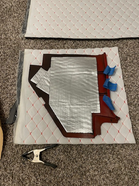

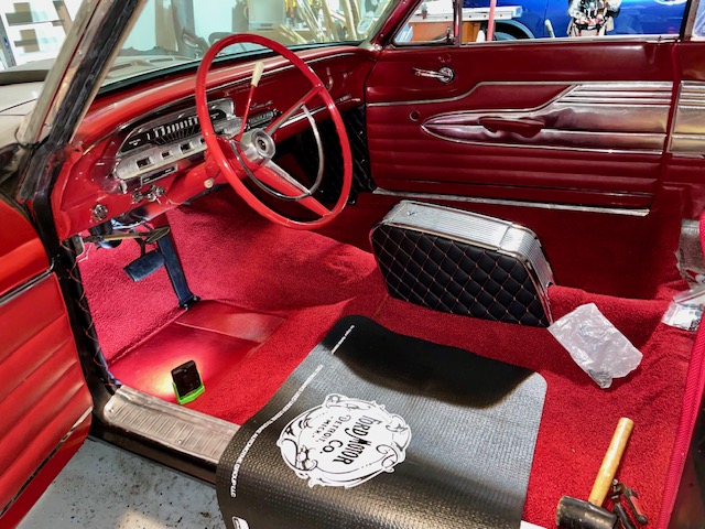

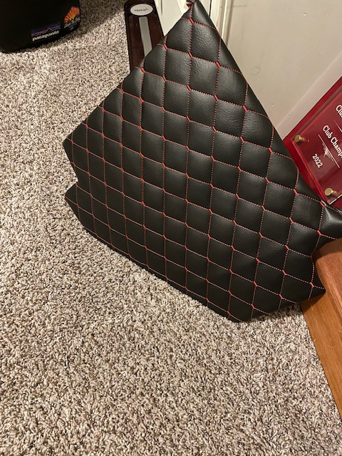

Also, dyed all the seats/carpet and pulled the hardware to refinish. Installed a pedal, headliner (custom faux-ostrich skin), and insulation. New weather stripping and rubber bumpers all around.
