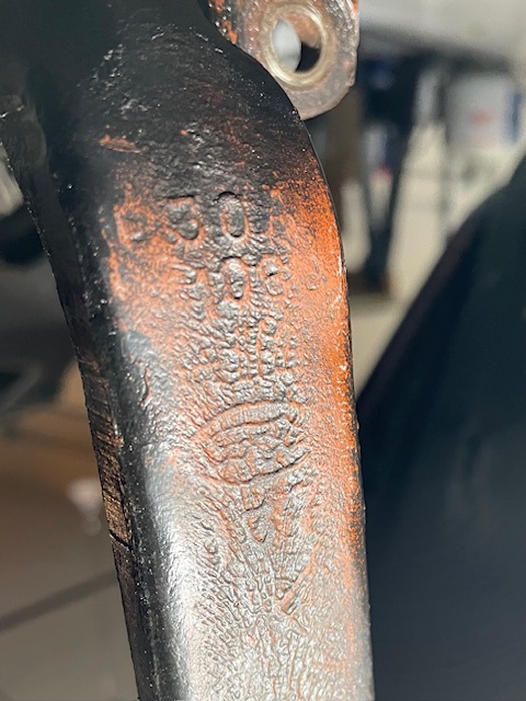

-63 Fairlane spindles (All I can make out on the spindles are: 30A

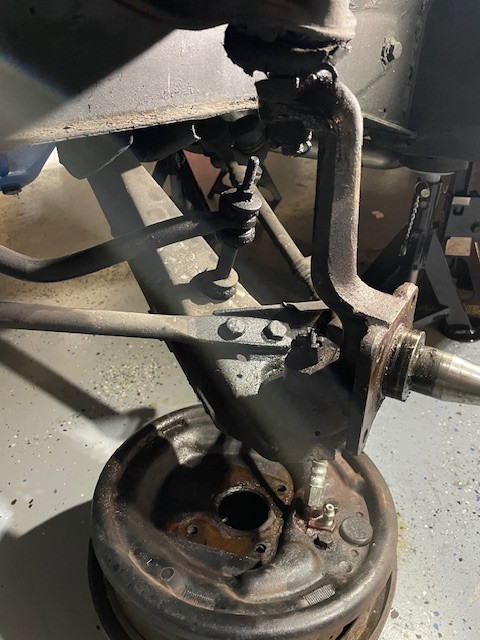

My current spindles:

Good Point! I found another suspension kit that comes with a a nice shim kit and a spindle. Maybe that is a better way to go. The spindle for that kit is a 70' spindle. I thought the 65' was the specific year to avoid bumpsteer but I get confused with this spindle stuff...
Does anyone know the exact spindle(s) that avoid bumpsteer issues but work well with the 65' steering upgrade?

I installed’70 Mustang Boss 302 spindles in my Cyclone back in 1972, I also converted to the ‘65 style steering. Along with the spindles I used the Boss disc brakes, everything worked well. I would probably still have that setup if I had not converted to a strut front suspension. You should be able to bolt in any pre 1974 Mustang V8 spindle and mate it to the ‘65 steering.
Posts: 7081
Re: Ol' Black Mattie 63' Comet Custom Build
I would stay with mustang spindles (they are same as 65 comet) . some have had good luck with granada spindles & some have reported bump steer issues. mustang/comet/falcon spindles will always be easier to find than granada's. & parts for them will be available for them a lot longer. If you went with all 65-66 steering parts & spindles would be easier to remember years later. the later spindles are beefier. Used 65-66 spindles pop up usually in the $200-250 range.
