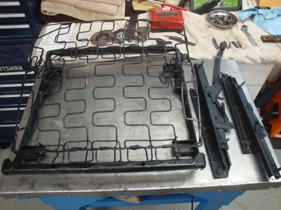

Part of my build is saving the factory bucket seats and reupholstering them. To that end yesterday and today were spent cleaning fasteners and fitting the front buckets into the new floor.
This is what I started with, I treated the seats themselves with SEM treatment and they will get epoxy primer before upholstery. The mounts has been previously cleaned and painted with epoxy primer.

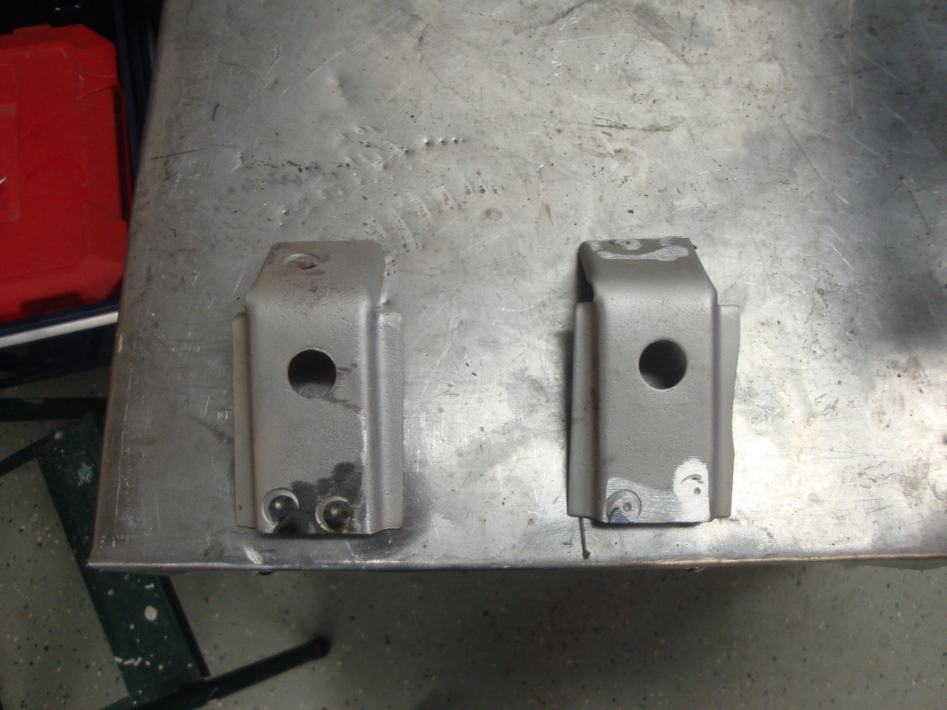

I saved these parts from the old removed floorpan figuring I could find a use for them. Beadblasted and prepped.

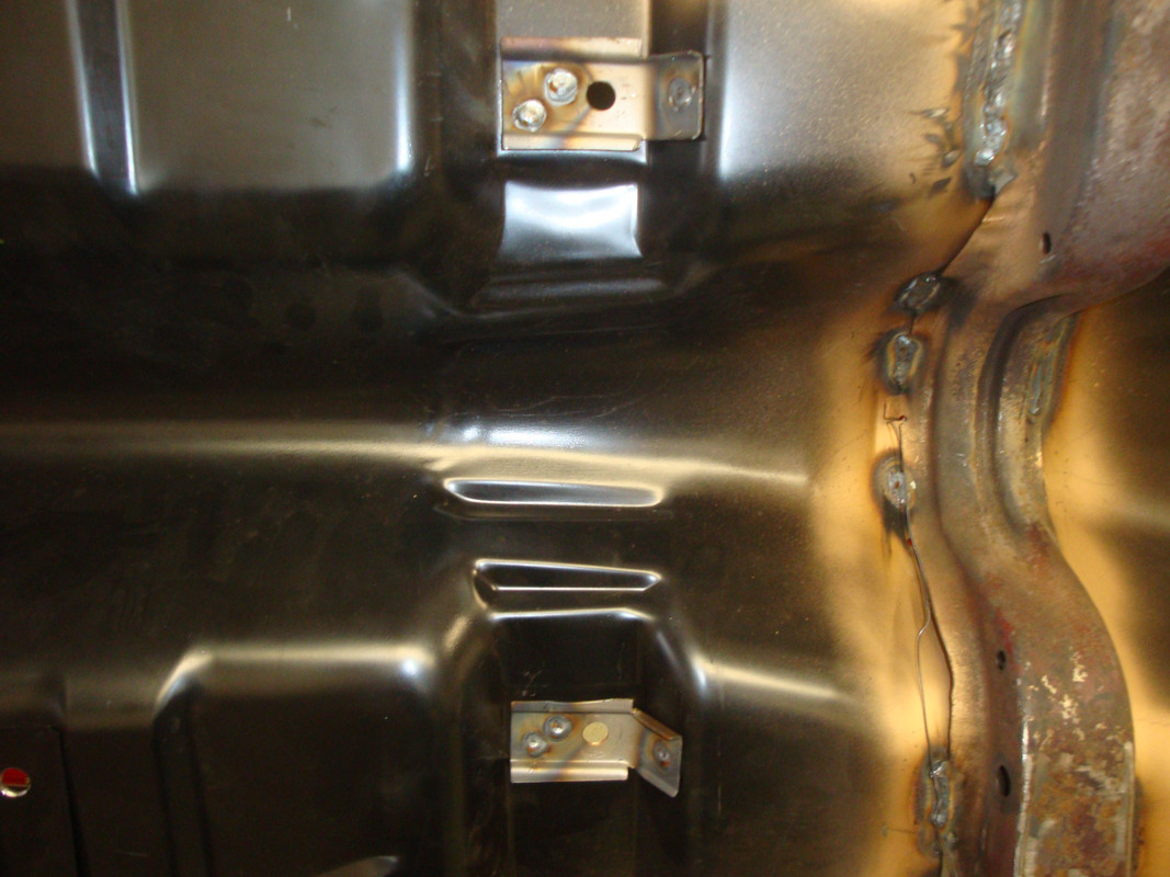

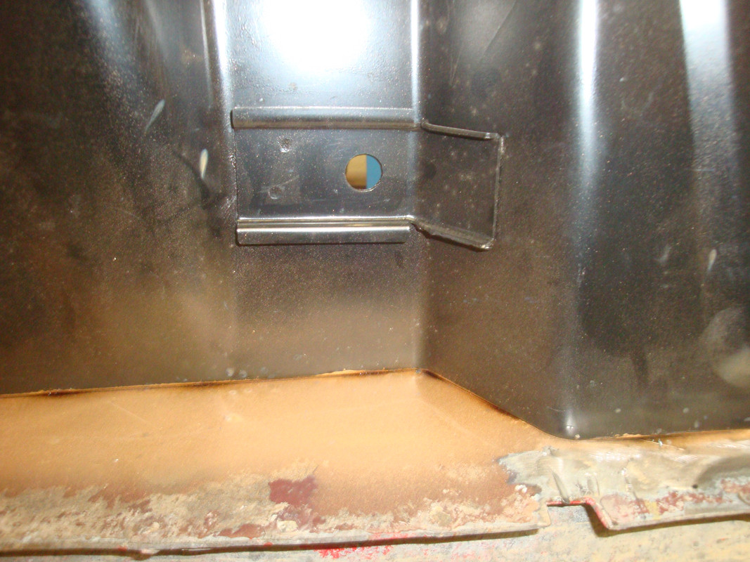

The inboard section of the floor had no holes and no reinforcement for bucket seats.
The new floorpan had these installed on the outboard edges.
Primed and ready for plug welding.
Plug welded in and ready for their new job:-)
