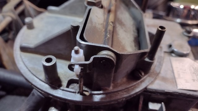

We got the small white plastic carb choke plate adjustment: (from Mikes Carbs) Glad these were still available!
It installed fine and was a direct replacement. Re set the adjustment screw on the underside back to the choke (fast idle screw) again! Finally got the correct spot (with the indicator mark) figured out where to set the screw on the mid point stop on the cam! Dang that is a hard one to see.
Car started up as expected when flooded. Choke closed when at full throttle and it fired up!

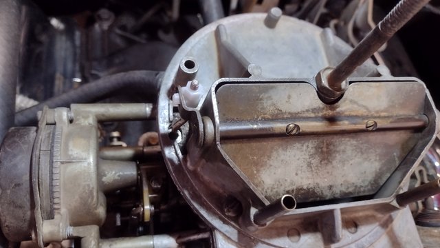

Here is a picture of my carb it has a lever on the accelerator pump that comes in contact with the pump. So I don't think the added cap will work??

You can get the same result by bending the small rod that runs from your linkage to the accelerator lever, on the side of the carb. It should have a slight bend in it so if you make the bend more pronounced it will shorten the rod, which will actuate the accelerator pump sooner. Just like the cap did for Jim.Sugarmaker wrote: ↑Fri Apr 19, 2024 10:20 pmJim,

Remove air cleaner, hold open choke plate and work throttle linkage. The accel pump should squirt gas as soon as you move the linkage. If it doesn't shorten/bend rod until it does.

You are correct the cap will not fit that carb. I see the link to the accelerator pump is already in the shortest position so the only way to quicken the action is to bend the rod. Have you installed a new diaphragm? Even if it is new is it in good condition?Sugarmaker wrote: ↑Fri Apr 19, 2024 10:20 pmJim,

Joe’s idea about the mechanical linkage is worth exploring, it may take a while but eventually you will solve the issue.
