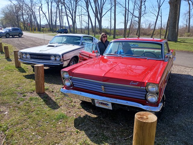

Cheryl watched as I finally gave the Comet a good hand washing. The weather was cool today but dry. Perfect day for a ride. Texted a friend in Erie and set up a short run to the lake and another tour around the state park.
Gordon has a very nice 68 Torino and is just getting his new to him 55 Tbird ready for touring this year too.
We had sandwiches and ice cream at Cream land then headed back to John and Cathy s place to visit. We joined them at the local Moose club for some fresh cut french fries. They drove "Howard" the 46 Ford,

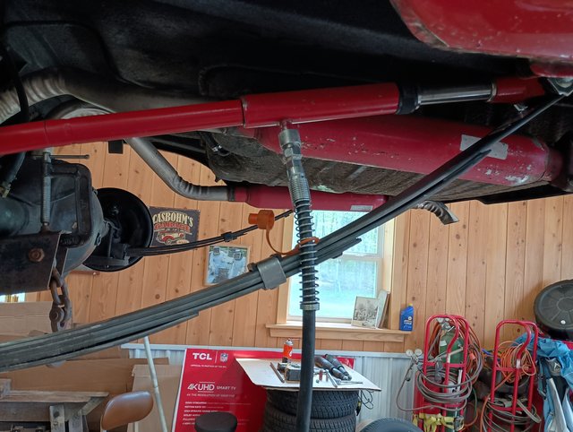

This arrived at the front of the house, Thanks FedX!
All parts looked good.
We used the engine lifter to support and adjust the rear end as we did assembled one side at a time.
All of the old fasteners came loose. Side note Eaton sent bandaids a long with their kit!
Old spring in front of the new spring assembly.
Re assembly:
This is the distance to move the front spring eye.
Installed the portapower to spread the spring.
It worked very good to bring the front spring eye into position.
Cleaned up the Ford original parts to be used.
We should have the Comet back together tomorrow. Happy with parts and fit so far. More later.

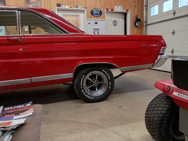

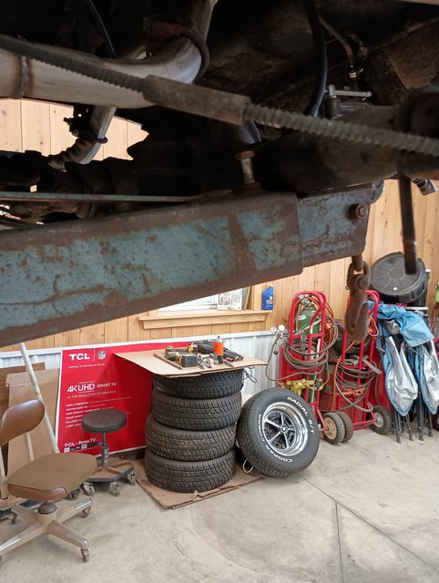

So the new springs are very stiff, pulling the shackles forward and the spring eye was up against the frame.
Before a test drive, after stretching the springs with the portapower and put new standard (not air) shocks in position.
After short drive Shackle position. We brought the shackle more vertical, but still slightly forward. After a drive around the block this is how it looked.
Yep its up there! Late 60's early 70's look.
The car was a little rougher in the ride. But I think the general handling was improved. The stance.... Well its about the look I wanted. It's not a tail dragger any more. Some may like it and some may not?

Looks like the stance is about the same as it was before using the air shocks. Is it? Hard to tell without a profile shot.

Yes its almost the same height now, as the air shocks at 100 psi. The front is now higher than when we got the car due to the new front coils. It looks like the clearance is there for the bigger tires on the rear? They might fill the wheel wells a little more as they are larger in dia by an inch or so. It is sfiffer with these new springs for sure. I was very happy with the springs, install kit, and shocks from Eaton Detroit Spring. US company, USA made parts. Not a full profile here, but the weather is not good outside.
Posts: 2941
Re: 1965 Comet Caliente (little red)
Looks like you gained about 2 inches compared to your sig pic.

I called Eaton again they said that the shackles need to be pointed to the rear. Well I tried the portapower again on both sides of the car, trying to get the shakles to stay back. When the pressure is released the spring tension brings the shackle back towards the front. That event maybe brought the dimension from floor to wheel well down about a 1/4 inch or so. I will keep you up to date if i come up with revelations or changes. Plan to go on some drives soon.

Eaton is correct, the preferred angle of the shackle should be off center to the rear but not too close to the frame rail when there is weight on the springs. The shackle needs to move when the spring flexes, it seems that your springs have quite a bit of arch in them. You may want to remove one leaf and see if the shackle relocates to its correct angle, you can always reinstall the leaf. I know that when I ordered my springs I specified how I wanted the car to sit and approximately how much weight I would have behind the rear axle line. ( I have a reversed eye on the front of the spring) I ended up adding a leaf, and driving the car so the springs settled, now the ride height is exactly where I wanted it to be. The shock absorbers should not carry any weight, their job is only to control compression and rebound.
The attached pictures may help, note the angle of the rear shackle.
