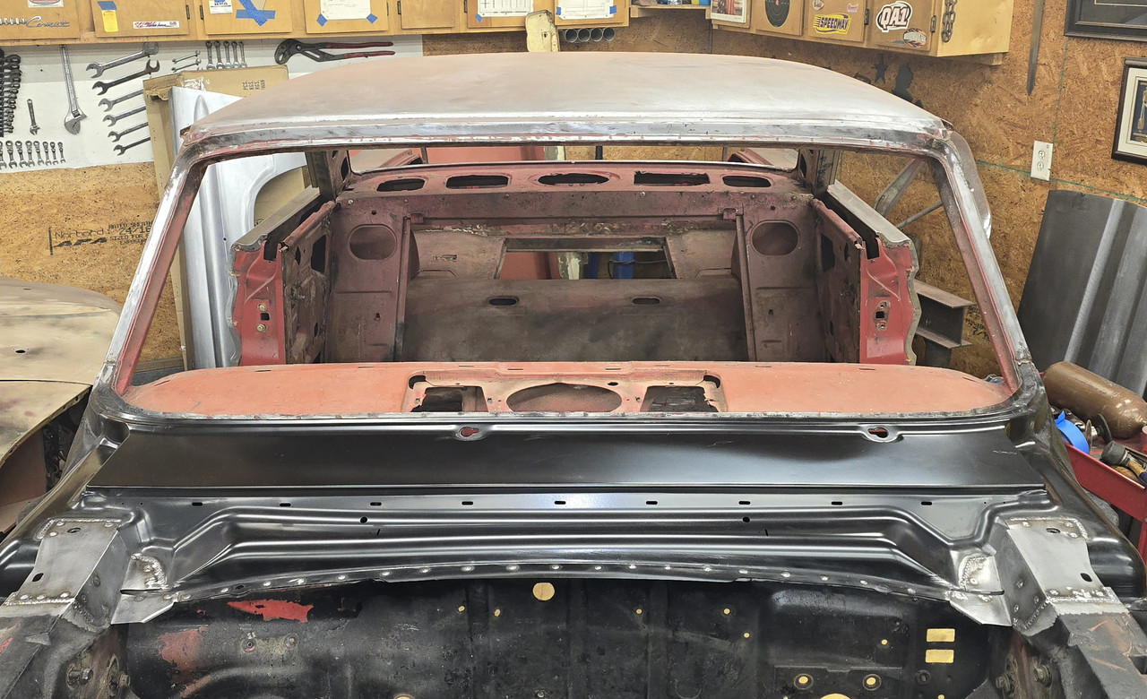

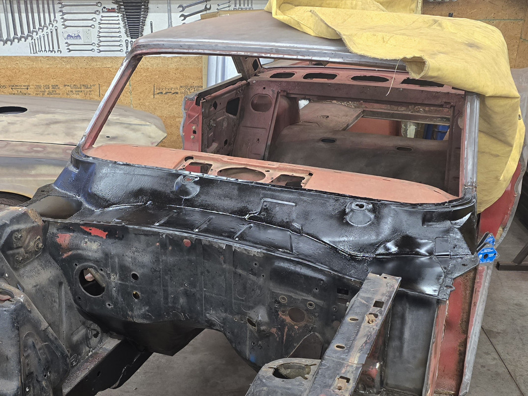

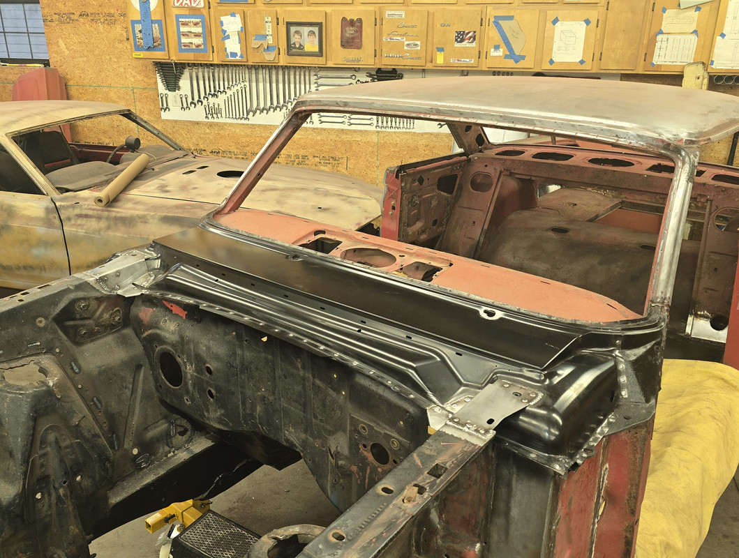

Moving along. Replaced all the rusty sheet metal under the cowl, reinstalled the cowl (76 spot welds) and the apron straps. Ordered an export brace from Melvins, so should wrap up the front end soon. More later - thanks for looking.

are you going to add a piece of angle to the area on the cowl lip where the export brace bolts on like the shelby's had? They were tacked on top of the lip but I put one under the lip so it wouldn't show so much . when you get the export on it hides it.
Thanks, Johnno. Not sure yet on attaching the brace; it should arrive this week so I'll figure it out then.

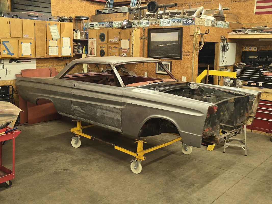

Progress continues. Stripped the other fender, hung the drivers door, aligned and set the fender in place. Goal is to continue until all stripped and aligned while fixing any remaining issues. Just tinkering along but this is the fun part! More later -
