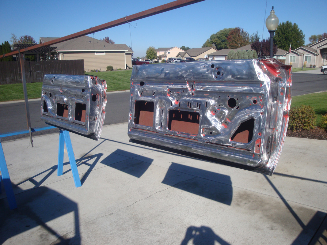

I had rust repair to do on both doors. At the bottom inside where the drains are. I bent up some 16. Gauge I have laying around and cut out rust and welded in the new metal. I finished stripping the doors to bare metal and got my epoxy primer and a couple coats of high build sandable on the doors today. The rust repair set me back a couple weeks as I didn't know it was there until I started on them. Next up will be the front fenders and headlight fixtures bonding them together. The right fender is a nos replacement and I have trim holes to weld closed as the cyclone does not have those holes. Photos are coming soon.
Re: Doug's 65 Cyclone build
After working myself into the ground I am well enough again to post a couple photos. I pushed myself a little too hard and got a bad cold.
Photo one is the rust damage I found on the bottom of the doors that I couldn't let stand.

I bent up some 16 GA and welded in some repair panels on both doors. This is a partial, I replaced all the metal on the bottoms.
I sanded the doors down to bare metal the best I could.

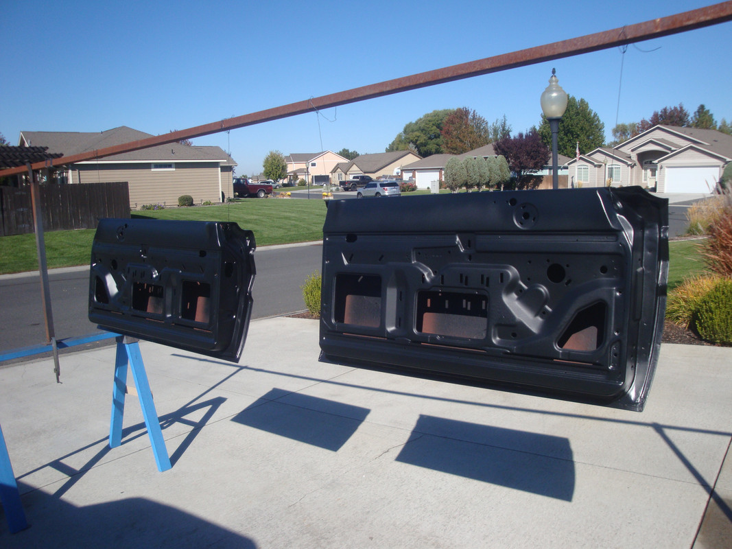

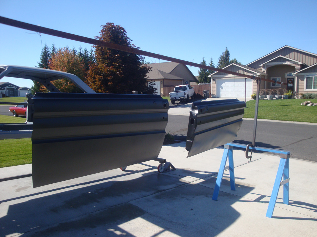

I painted a couple heavy coats of epoxy primer on the bare metal and followed it up with a couple heavy coats of sandable primer on the same day. the doors are now ready to hang on the car. Next up for me will be bonding the headlight buckets to the fenders and prepping them but I will lose my weather window soon----------
