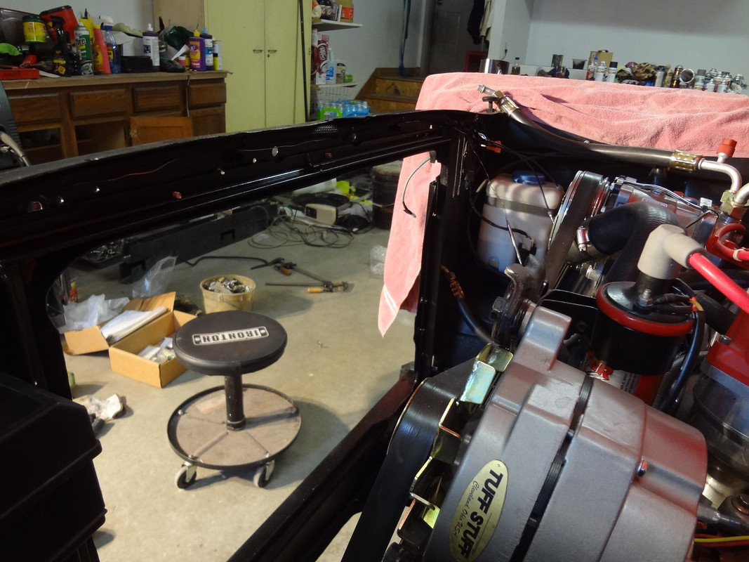

Here is a picture Mike of the water pump pulley between the 2 fans like your thinking. This set up gained me 3/8" from my old set up.
tom

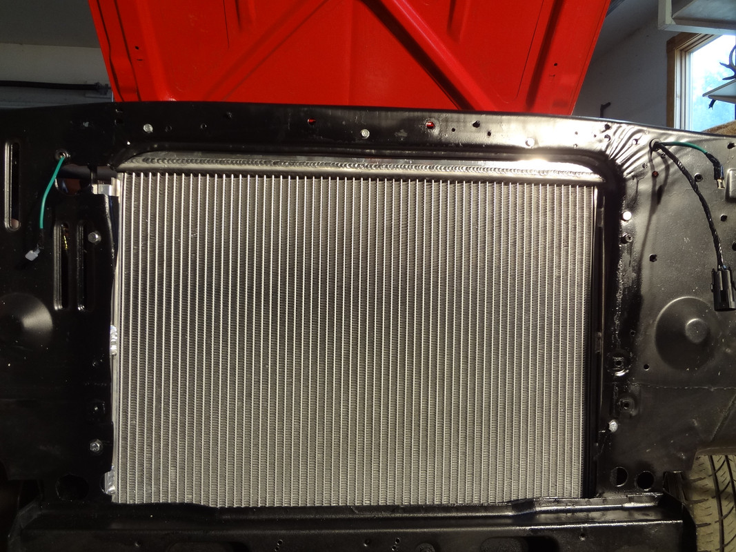

I finally got to putting it back together. First I installed the angle iron bracket which fits behind the radiator mount.
The picture doesn't show it very well. I then mounted the radiator to the angle iron thru the radiator mount with the bottom as close to the radiator mount as possible without touching the mount. The top of the radiator slants back a little so that the cap is accessible. I still had to cut out the top a little.
Then added the shroud and fans.
So far it all seems to be working out
Thanks for looking
tom

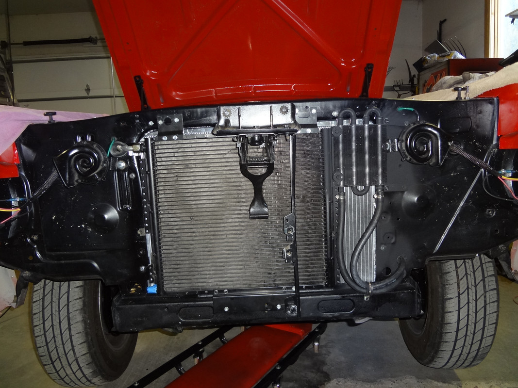

I finally got the AC condenser and a new transmission cooler installed. The front looks a lot more cleaner than it used too.
I need a new AC line made with a different fitting than I had to finish it. I probably won't get that done now until this virus thing is over. We go on lock down tomorrow at 8 am.
