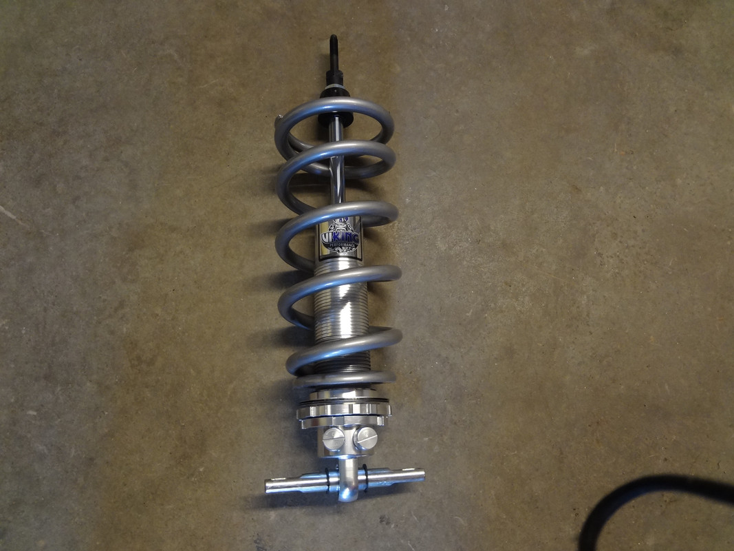

This past week I finally started my winter project. I was struggling with some health issues but I'm feeling pretty good now. This is one of the front coil over shocks I'm installing.
I wanted to raise the front end 1" and get a better ride. Here is a picture of one installed.
I still need to align the front end but I took it for a ride and it sure rides a lot smoother. I think I'm getting it where I want it. :D

I really like those ! what did they cost? yea all those adjustments would help me out a lot too! those are rebound & dampening knobs right?
I paid under $700.00 for the entire kit. They have 22 adjustments for compression and rebound to give you comfort or handling or somewhere in between. They also have a stiffer shock for better handling that is totally adjustable also. You can look them up at www.vi-king.com. There out of Lakeville, MN

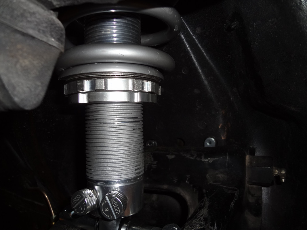

Here is a picture of how far I ran the retaining nuts up the shock to get the height I wanted. The snubber is left of the shock.
Tom
