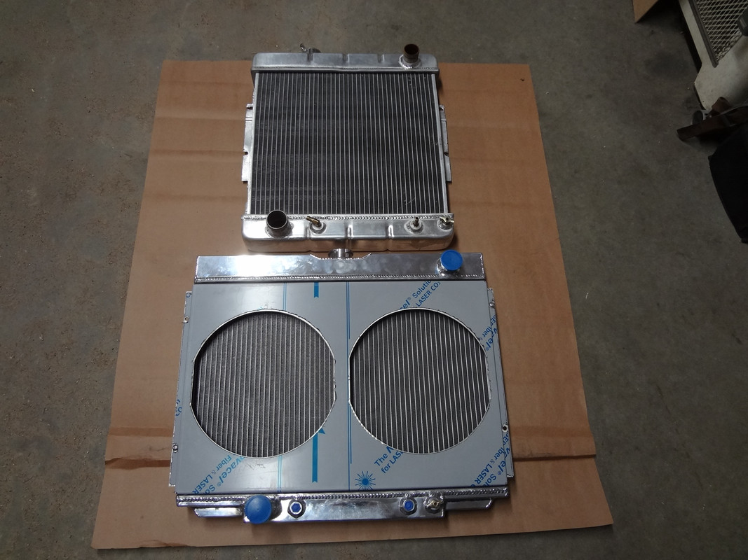

Another problem came up this summer when the temperature got over 90 degrees. My cooling system couldn't keep it cool with the AC on. So I purchased another radiator. I got the one that Mike talked about getting from Champion radiators. It's designed for early big block fords. Here is a picture of it along side my old one. As you can see it's bigger than the old one. I also got the fan shrowed and fans for it.

tomb22 wrote:So I purchased another radiator. I got the one that Mike talked about getting from Champion radiators. It's designed for early big block fords
Cool 8) Yes I have a new one sitting in a box waiting for me to get to that point (Champion EC375) I bought it last summer.
I haven't got around to modding the core support or mocking it up yet, just yesterday or so I ordered a new Ford Contour electric fan(s) and should get it this week, hopefully it won't all stay so cool it freezes my little 250 solid :P
I am hoping when I get it in there I can push it further forward than the original and fit a stock 69-70 Mustang A/C condenser on there.
Thanks for the pictures Tom it helps me see what I have coming ahead of me.

Did you havd a shroud on the small rad?

SASSY wrote:Did you havd a shroud on the small rad?
I didn't have a shroud on the small radiator. I didn't have the room and I didn't try to make room like I 'm doing now. I had a 16" puller fan and 2- 8" pusher fans. I also had a AC condenser and a trans cooler in front of the old radiator. It worked great until the outside temperature got over 90 degrees :(
This time I moved the the radiator as far forward as I could get it and made the opening 23 1/8" wide. I'll still have the AC condenser but the trans cooler needs a new spot or I need to get a smaller one.

Put the trans cooler in the front wheel house behind the headlights with a fan. ,,, Better yet start searching for a third pedal assembly :lol:

That's not a bad idea to put the cooler in front of the wheel house; in fact both those ideas aren't bad :lol:
