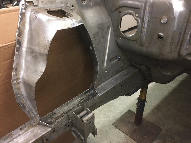

When I first installed the Boss engine in 1972 it was from a wrecked ‘70 Boss Mustang that I bought, I used almost every mechanical part from that car in the ‘64 and the Comet GT I had. The engine went into the Cyclone without cutting or other modifications except the change to ‘65 style steering. This time around I am using aluminum heads, roller cam, etc. I did section the shock towers for more working room since I do not have upper control arms to deal with. Here is a shock tower after I sectioned it.

Re: ‘64 Cyclone update
Thanks for the pics, Jim!
Again, really nice work and a beast of a car.

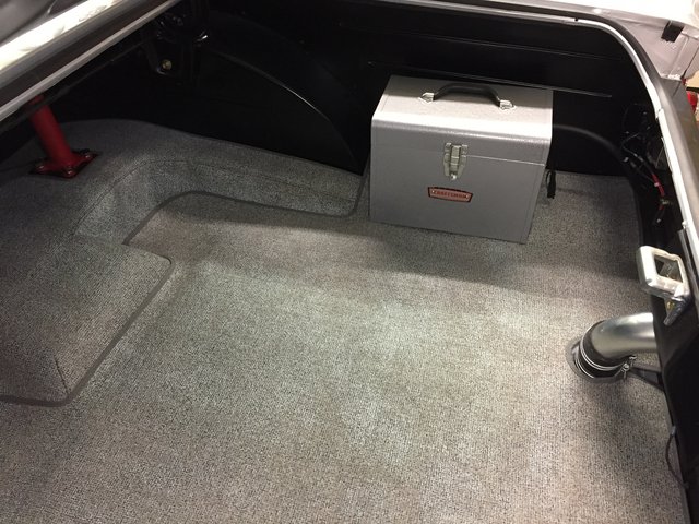

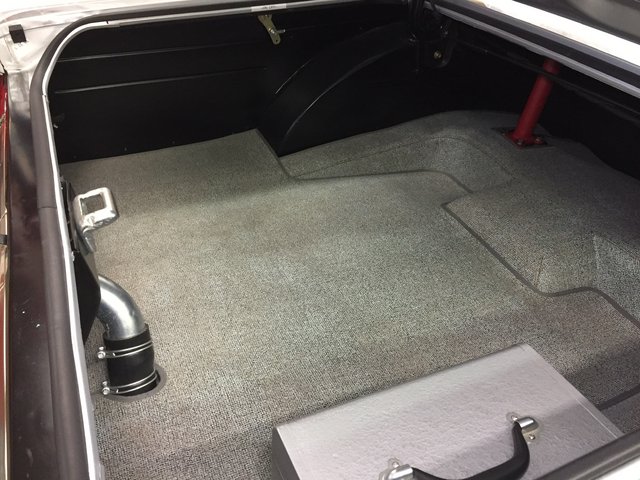

We were able to finish the trunk, my interior guy was busy so I did not press him before this,
I bought a roll of factory style material so he had to cut a sew it to fit the contours of the trunk. With the new inner wheel houses and the hump to clear the rear end housing a pre cut mat would not even come close to fitting the space.

Here is what the trunk looks like now:
It looks really really good Jim, I probably should have added a lot more reallys
