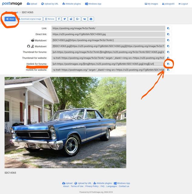

here are some tips on using postimage, for pic posting
https://cometcentral.com/forum/viewtopi ... ing#p97294
