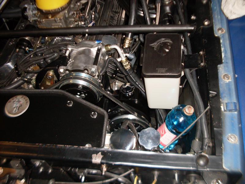

I got a cheap SS one from ebay. It was like this one but with free shipping I think;
https://www.ebay.com/itm/2-x-13-Custom- ... 23bb1acb1c

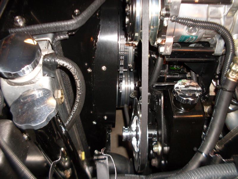

It had a nice polished alum cap that kinda sorta matched my rad cap. I like the skinny little thing ! :) I might not like it so much if I work on the voltage reg.. :lol: but it easy to find a place for it, I already moved it once.
the bottle concentrate also kept it from freezing up in the winter. back then most service stations didn't sell washer fluid so you had to carry it with you,but they did have water so that's why it came to be.
here's my bottle;

Posts: 5920
Re: 1965 Coolant Overflow Tank?
lavron wrote:
Sat Jul 25, 2020 5:19 pm
Sat Jul 25, 2020 1:43 pm
https://www.ebay.com/itm/2-x-13-Custom- ... 0903.m5276
I have a plastic one that I took out of something in the junkyard long ago, I like that skinny one I might have to look into getting one similar, I actually painted mine so it would not look so modern, most of that peeled off of course.
There are some longer ones,shorter fatter ones on there too, I think someone on here has one of the slightly fatter ones, maybe Jim ?(AFX) :?
