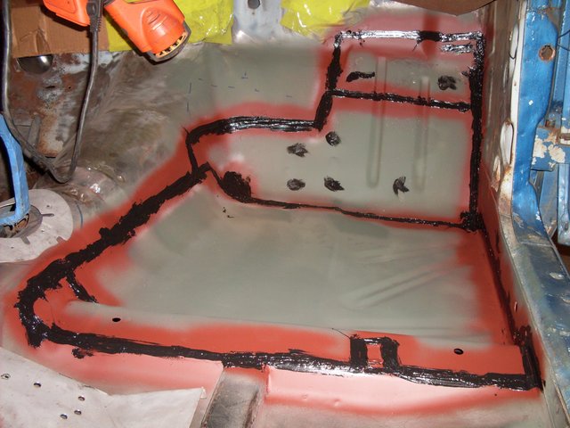

I cant say about the full floor piece but I bought the floors & toeboards from autokrafters & the toeboards were not tall enough for my needs so I had to add a piece from a parts car. this may give you an idea of how tall the toeboards are,(the center piece);
they were 90 bucks, if I did it again I'd make them from scratch, they weren't that great,needed lots of finesse. the fluted beads could be beat in pretty easy in a wood mold,especially in the time I waited while one of them was on back order ,the rest of it I had to rework anyway. but I liked the floors.

I bought mine over 20 years ago and they looked the same as the ones John used, they were long enough for me and I ended up using just a ssmall piece on the passenger side (my floor was good on the passenger side as well)
If I was to do it again I might make mine myself as well.
