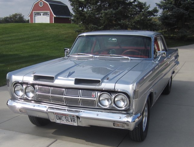

My 65 has no side mirrors and I see no evidence it ever had them. I've owned it for 26 years. Looked inside the door and no noticable repair.
cycloneside - Edited.jpg (57.22 KiB) Viewed 117 times
