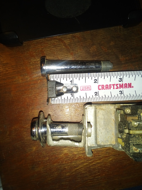

Can someone snap me a pic of the '64 nut that holds the headlight switch? Parts places claim '63 & '64 switches interchange but I don't know about the long shaft bezel runs through the dashboard. The '63 has a plate behind the dash the 'nut' runs through to mount the switch behind the plate. Mine was barely holding on before I had to pull it. It was stripped long ago and needs replacing. Looking for interchange, if possible. These are hard to find (as usual).

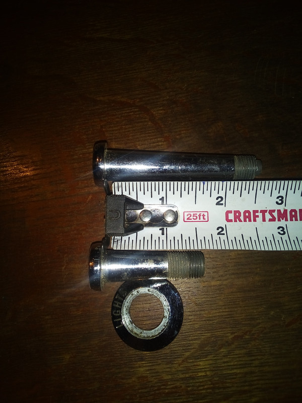

Thanks for the pics, John. The '65 nut is available but the shorter '64 (the one I need) isn't. The '63 & '64 switch is the same but '65 is not by sources I've checked. The '63 looks to be the same length as the '64 but has a bezel attached on the knob end that matches the others. Plain w/ no 'Lights' stamping. 'Lights' stamping is on the instrument cluster.poboyjo65 wrote: ↑Fri Sep 17, 2021 12:35 amI put 64 knobs on my 65 because I liked them better,but still have the 64 nut ,, threads broke too. probably would have been about a 1/4'' longer before it got broke off. in the first pic is a 64 & 65 nut .2nd pic is of the 65 switch minus the dome light dimming mechanism.
At this point, I would be happy to find any the right length, regardless of bezel just to keep the dang switch mounted. Will post pics later today, hopefully.

I had to remove the "Lights" ring in order to get enough thread to bite. I looked for a replacement as well, but could not find. Seems one would need a donor car

So do I have them mixed up? this shorter one that I have (1 5/8 underhead length) I thought was the 65. if this is the length you need you can have it. the switch has what looks like a C5_ _ -_ _ _ _ part number so I think it is the 65 switch?Joe Travers wrote: ↑Fri Sep 17, 2021 7:05 amThanks for the pics, John. The '65 nut is available but the shorter '64 (the one I need) isn't. The '63 & '64 switch is the same but '65 is not by sources I've checked. The '63 looks to be the same length as the '64 but has a bezel attached on the knob end that matches the others. Plain w/ no 'Lights' stamping. 'Lights' stamping is on the instrument cluster.poboyjo65 wrote: ↑Fri Sep 17, 2021 12:35 amI put 64 knobs on my 65 because I liked them better,but still have the 64 nut ,, threads broke too. probably would have been about a 1/4'' longer before it got broke off. in the first pic is a 64 & 65 nut .2nd pic is of the 65 switch minus the dome light dimming mechanism.
Thanks, as always
The longer one should be about 2 3/4'' I thought it was the 64 bezel nut?
