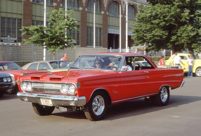

A 6” rim is too narrow for a 2.35, you should use a 7” minimum. A 60 series might be too tall also, the outer wheel house on a ‘64 is narrow at the top. Back in the ‘70’s I ran a 2.35 - 50 on a 7” wide, positive offset rim on my Cyclone, it just fit. The front of the wheel opening was real close to the tire, and the car was too high in the rear for my current taste. ( but it was in vogue at the time)
Here is what it looked like back in the day....
