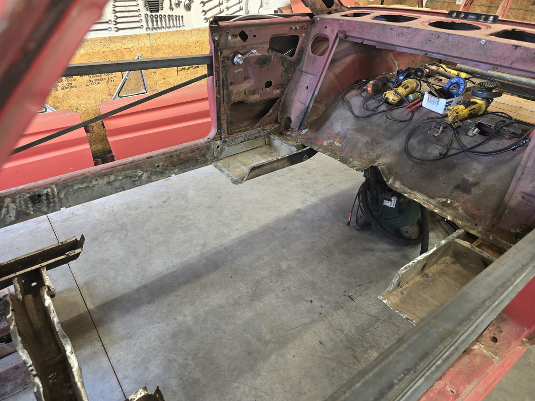

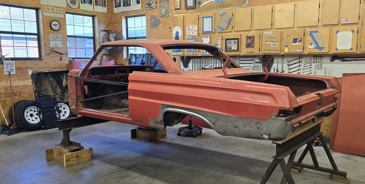

Still making progress. Body is stripped for now and braced off. It's amazing how light these cars are once stripped down; heck i can pick up either end off the sawhorses myself! Pulled dimensions and then got distracted stripping a little paint from the drivers trunk drop; not too bad, just a little rust and mud to remove. Whittling away at floor removal now; more later!
Dan

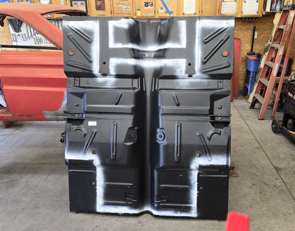

Well, still pushing. Just taking an afternoon here and there till this floor is done! Was supposed to take a ride to Michigan this weekend to grab a rotisserie from a fellow CC member, but being on call for work stopped that. So, after getting called in this morning decided to get to the point of test-fitting the floor once I got home. Still a long way to go, but now I can Cleco it in, get it fitted and keep moving forward. Still have to fab toe boards, some patches to the wheel wells, etc but I'm closer than I was.
More later -

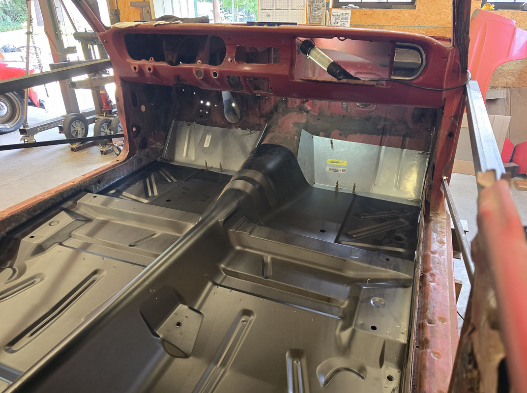

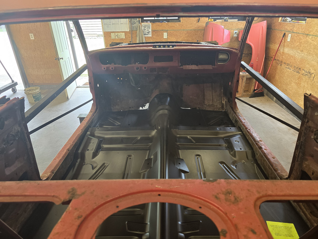

Spent my father's day morning tinkering on the 65. Was able to get the toeboards fitted and a little more prep for the one-piece floor install. Ordered a set of the Tin Man SFC's to install while the floor is out (thanks for the tip, Rootsy) to save a little aggravation later on. I'll pick up some weld-thru primer this week and should be able to start welding then in soon.
More later -
Dan

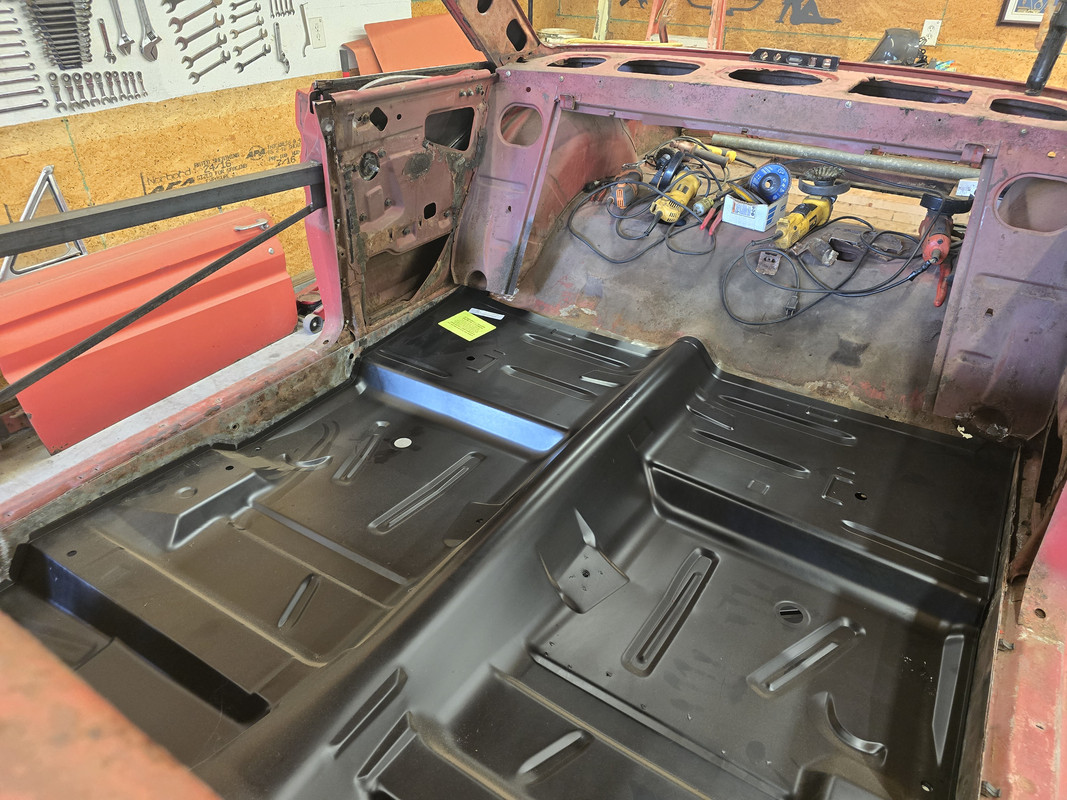

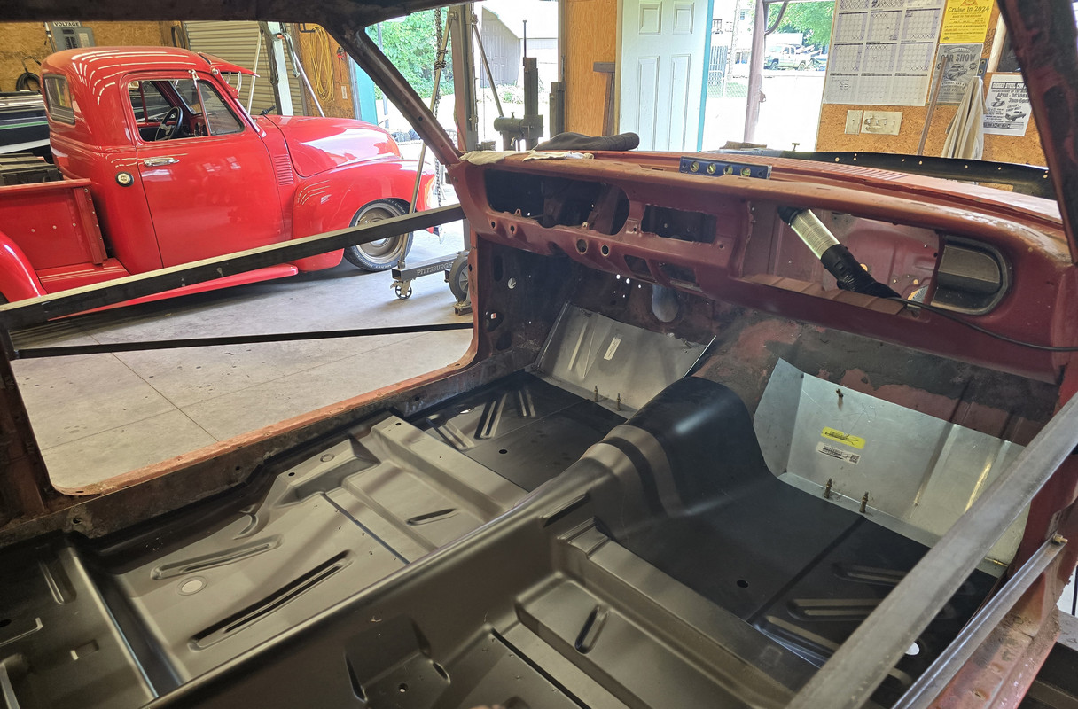

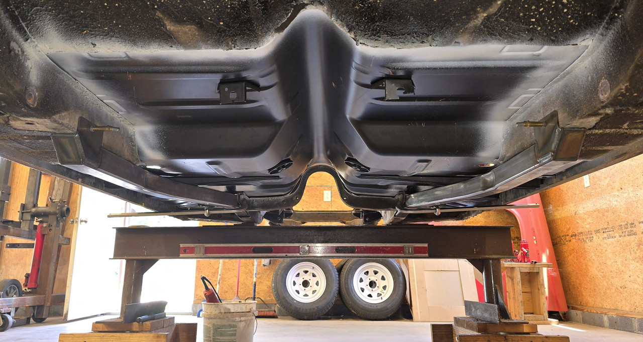

A little further. Focusing on getting everything fitted and exactly where I want it, so in-out-repeat multiple times to check and adjust. Fitted the Tinman SFC's also; was extremely happy with the accuracy of the bends.
Also located a good 351W block local, so I'll get that home next weekend. All in all just plowing forward.

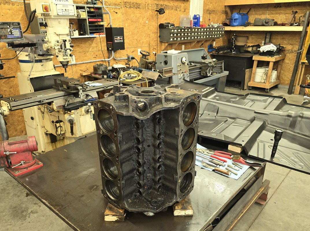

More progress and a little good luck. A friend of a friend had a 351W block, so I took a chance and checked it out. Ended up meeting a cool fella just a few miles away and picked up a short block to get started with. D9 block - minimal wear - heck, I couldn't tell if it had ever even been apart. Bores all miked out at 4.002-4.003, crank and rods looked great. A little clean up here and it'll get hot tanked / magnafluxed then I'll use it for mockup / header fab before building - 408 I'm thinking . . . . .?

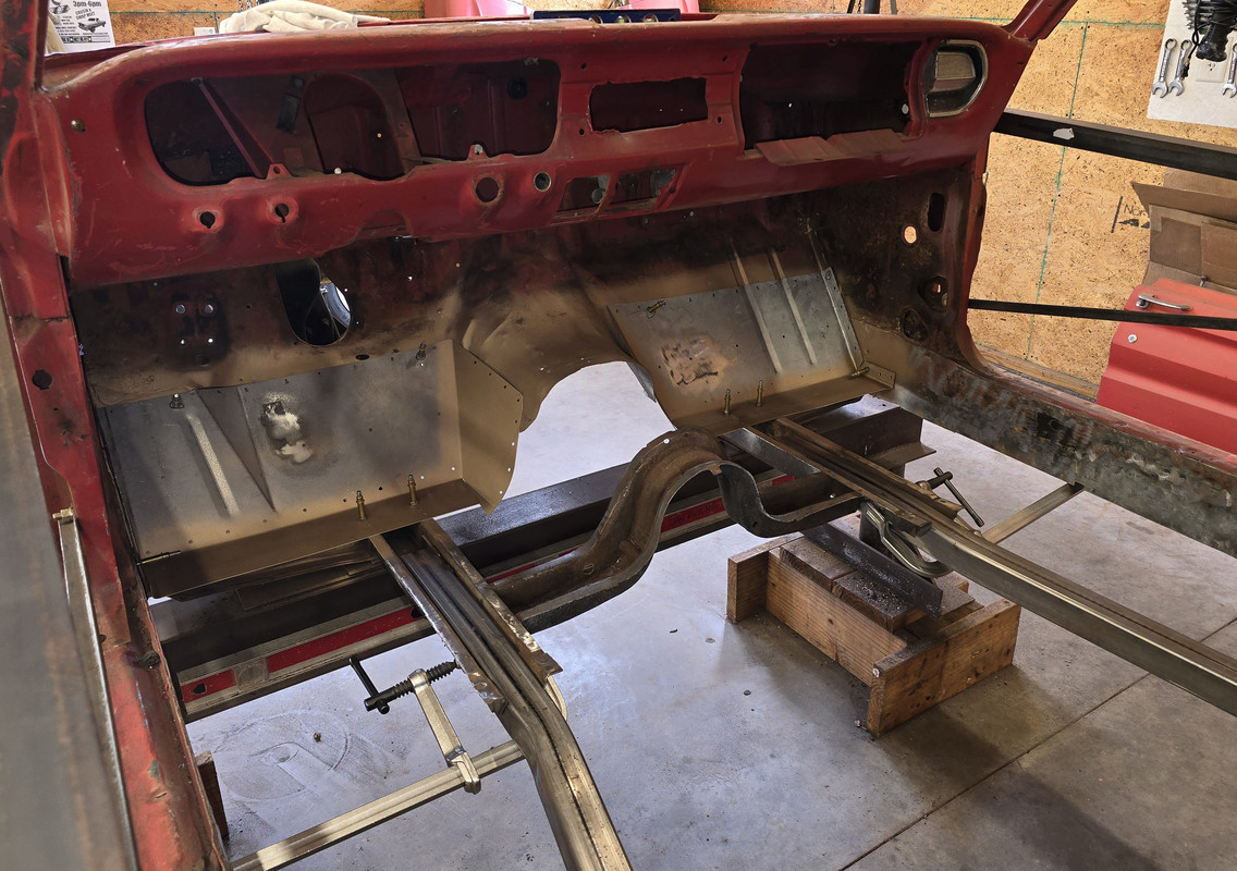

Cleaned up the toeboard area to start getting the floor installed as well, so moving along there as well.
Dan
