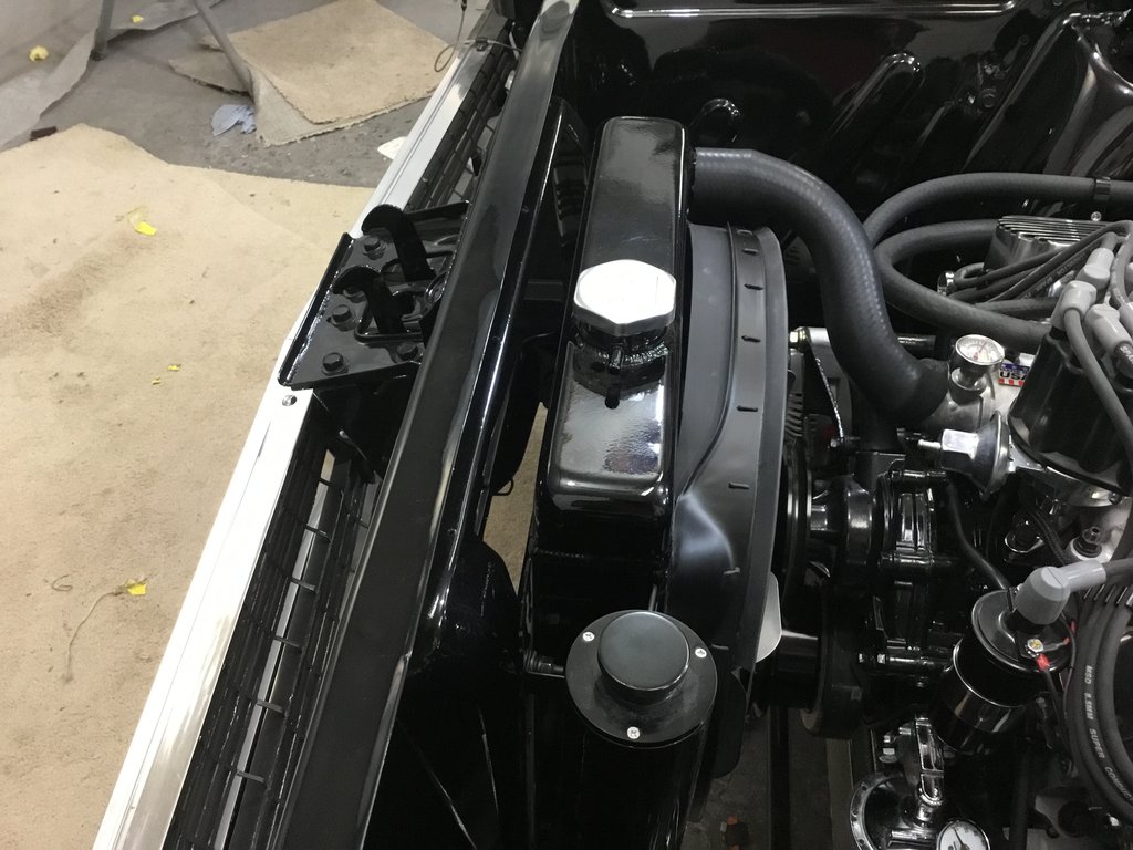

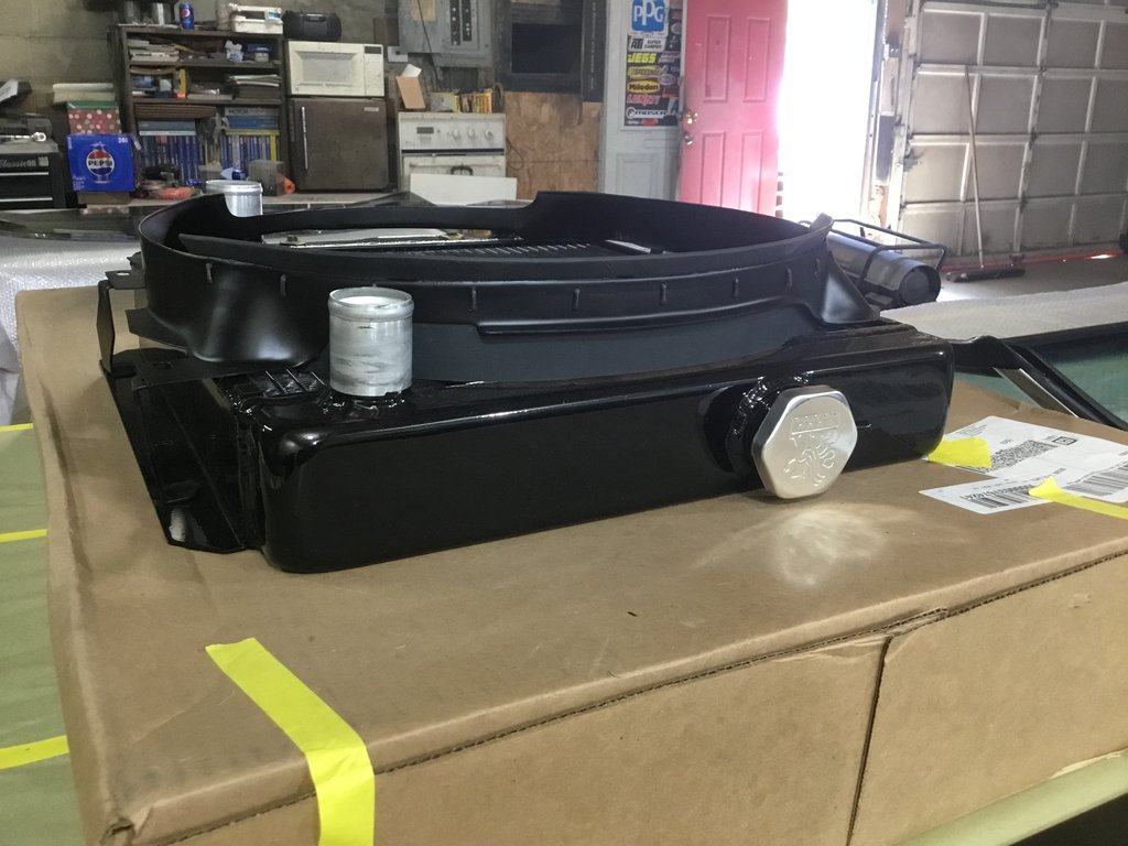

Been trying to finish up the cooling system, and some detail stuff on engine.

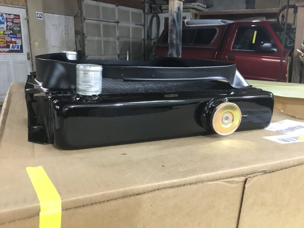

Went back and forth on shrouds. Finally ended up getting the original metal type, with the appropriate brackets. When I test fitted everything there was a gap between the shroud and rad at the top that I wasn't happy with.

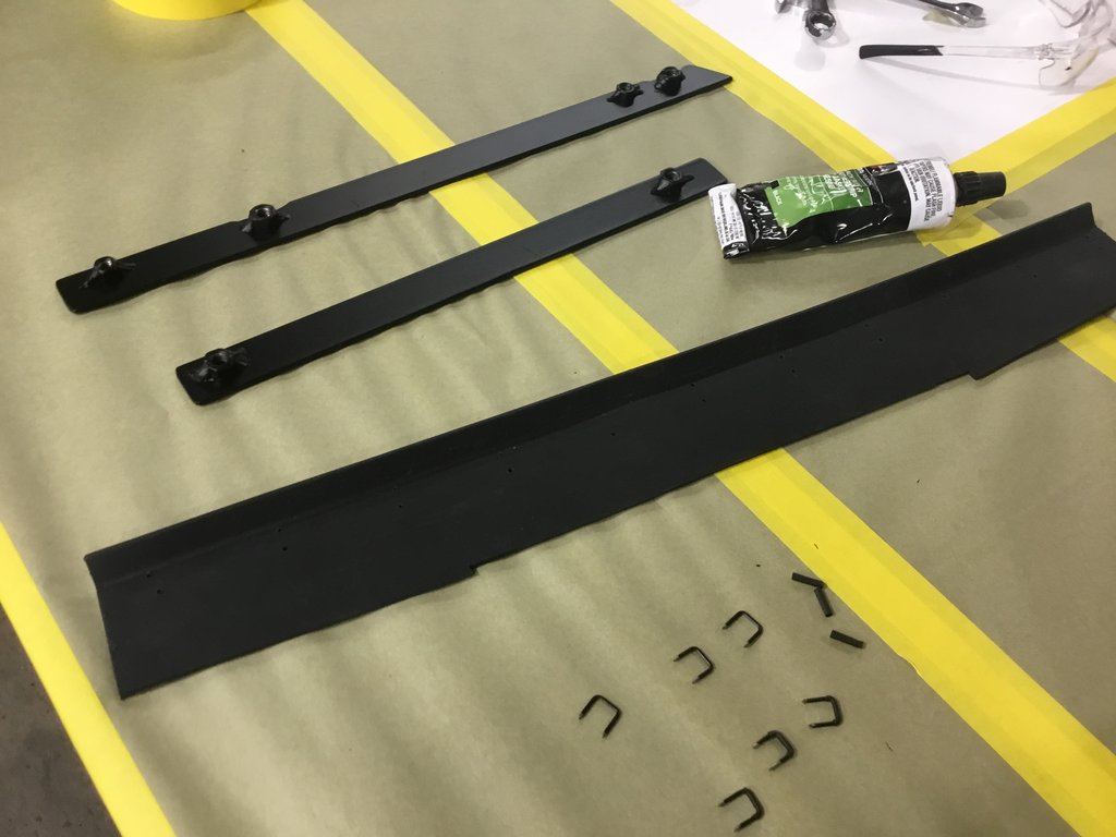

Decided to make a filler piece to seal gap up and hopefully pull more air thru rad. I used rubber to seal it, actually commercial rubber floor coving. Cut it to fit and used staples and a little weatherstrip adhesive to attach to shroud.
When done it seals it pretty nice. And doesn't look out of place.

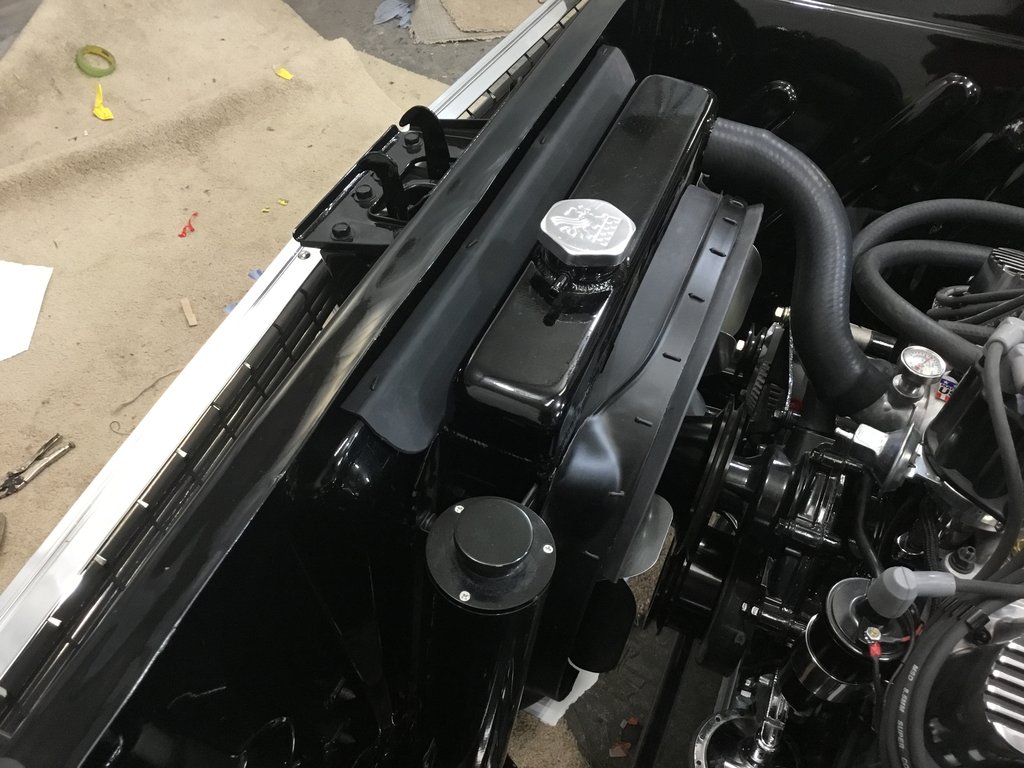

When I installed rad in car I also had a gap between front of rad and rad support.
Used the same procedure, rubber, adhesive, and a few staples. Sealed the gap and it matches the shroud seal.

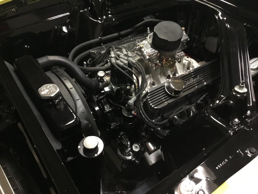

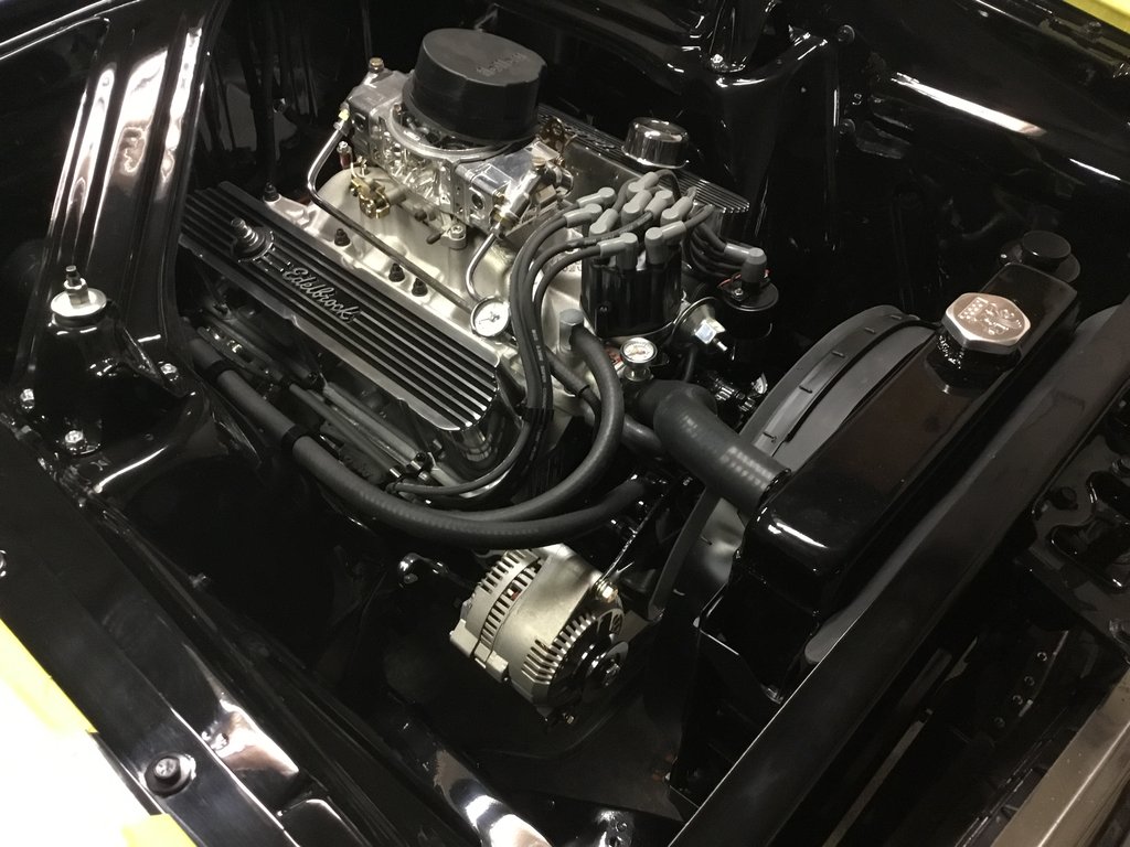

Got the fuel line mounted to block, started mounting heater hoses to pass side apron. Got to finish up rad hoses and some small stuff, the should be able to fire it up . Couple picts of how engine looks so far. Will paint the next oil filter black so it blends in.

Looking real good Lou. Nice work on the rad, blends great, and should function well. Like the stance!

Thanks Lee,
Hoping it helps, don't want cooling issues!
