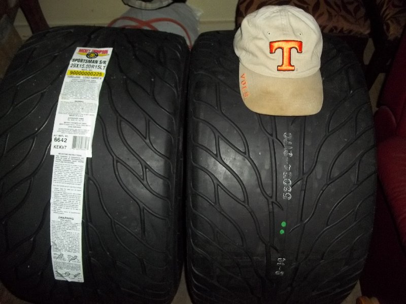

Been trying to fit these 29-15.0-15 tires out back. it seems like more fun to do & with the gentle spring riding days behind & too hot to ride much I figured now is a good time to have it semi out off the road. I just hate to take it out of commission during the pretty days!
having to use 3/8 wheel spacers because the guy who narrowed my rearend goofed up & cut it about 3/4 too short ,,or about 3/8 on each side. so I had it measured right
I made some mock up lowering blocks ,couple different sets,that let me move the axle back & forward . I went back 1 3/8 first, then 7/8. so now I'm making some better ones, aluminum ones to give it a test drive & possibly run for a while until I do the quarters .That way I can order the split mono leafs with the the pin in the stock location & keep using these block until then I'll try an inch back first. That was the goal * I have another 9'' diff set up with new 350 gears & a 1'' longer pinion yoke ,,,so hopefully my drive shaft will still be long enough. I haven't put it in yet ,I wanted to do some eyeballin before all that because I need to change a leaking axle bearing . I ordered 2 new ones.
