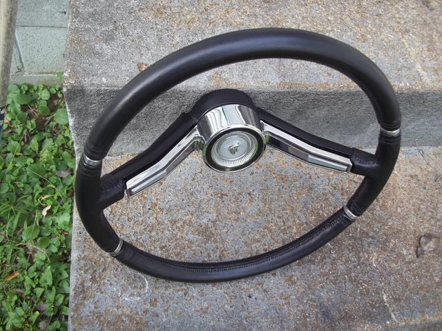

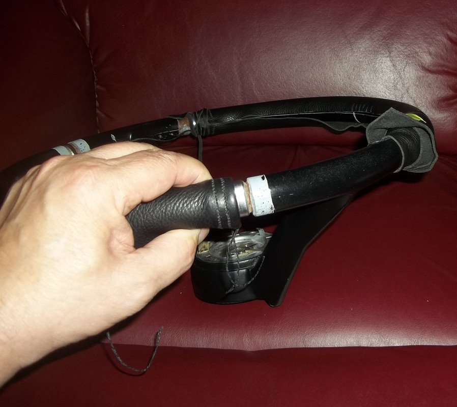

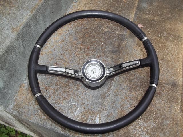

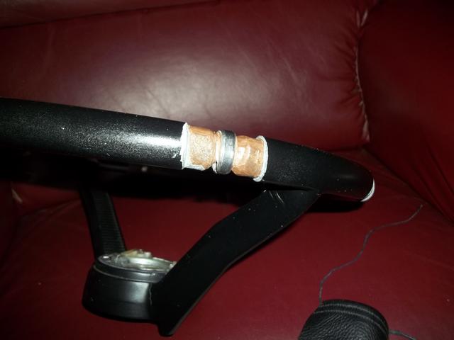

Well I decided to wait about reinstalling the ac unit & insulate my firewall better. I cant get under there with the seats in ,so that makes it more time consuming,>easier to procrastinate. just have too much fun driving it to take it out of service.
I put a leather steering wheel cover on but was not satisfied with it, so I made my own. it's actually 4 separate pieces. When I put the first one on covering the 4 SS bands up it looked kinda plain without them.
The store bought cover didn't fit my wheel good because of my epoxy build up a little fatter here & there so it really needed to be cut to fit. I did some practicing on stitching,watched a bunch of youtube vids, even some making baseballs
but one guy doing wheels didnt say anything, sometimes he would put up descriptions on the screen explaining what & why he was doing . I really liked him & learned from him , & I made a jig kinda like his to hold the wheel.
I wanted a tight stitch, 1/8th'' apart .
the sides were a little tricky. One wrinkle on back of each spoke ,no way to get it out with out another seam, which wouldnt look bad,might even look kinda cool but I've got use to the feel of these wrinkles by now
I forgot to get a pic of them.

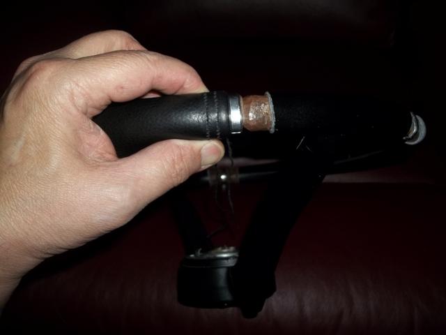

I got a shoe repair shop to sew the 2 rolls of stitching on each side of the bands,leaving a channel in the ends for draw strings & whittled grooves beside the bands for the strings to draw into & hold each end stretched out.
You can see how much bigger it was, I whittled it down to the old wheel to make room for the doubled leather ends.& if I left it like this the draw string didnt want to seat down in the groove I made for it.
this is how it would have looked if I hadn't made room for the double thickness of leather edge
whittling the epoxy off made it fit better.
I haven't driven it yet ,,but it has a good feel,so far I like it.

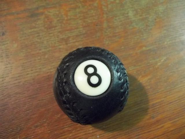

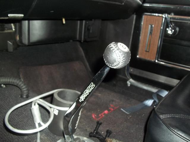

good feel ,better grip, & will be warmer in the winter. so you have a lot of time to think while you're doing all that sewing. the quiet guy in the videos also covered a shifter knob in leather ,& I had watched the baseball making video ,I decided to try my luck & make a little leather jacket for my little 8 ball shifter knob. it's smaller than a real pool ball, bout 1 1/2'' diameter. It feels pretty good , I haven't seen anyone else with one so I think I'll keep it!

That's outstanding - awesome job, especially on the shifter! Now you're planting ideas for a cue ball I own that has certain "unspoken" historical significance from my Navy days . . .
