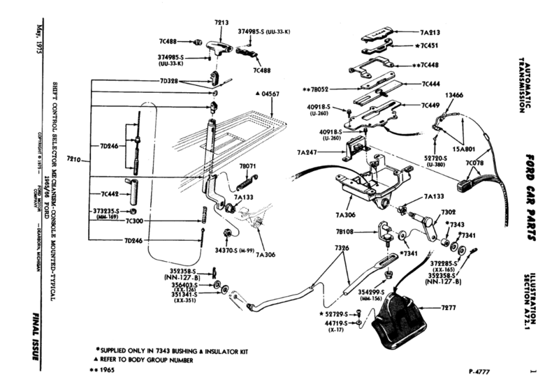

I got my shifter rebuilt, cleaned up and working perfectly. And my kid knocked it off the counter onto the tile floor, swept the pieces that he could find back up and set it back on the counter without telling me. I can't get the button to engage anymore so I know it's wrong. I can't find a breakdown of it online. Does someone have some pictures of assembly so I can get this thing going again? There is a spring here that may or may not go in the handle, but I haven't had any luck getting it to operate. Also, it's been over a month since I did it and I just don't remember how it worked.
It's the '66 floor shifter for the C4 with the FoMoCo logo on it.

did it have a t handle? here are a couple 3 fords , does it have a console or just a lone shifter & base? there was another one with a round knob, I'm not real familiar with 66 & later.
but this is where I find them ,you gotta look thru it, & some stuff is hidden in the wrong sections .all the diagrams are on the left side. it was in the auto trans section;
https://www.squarebirds.org/Manuals/196 ... talogs.htm

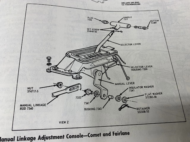

[*]This is all I could find in my manual. Johno, tough visuals on that link, my eyes aren’t seeing it to good.

Caveman that one of yours looks like a closer up version of the center diagram I posted . yea I have to zoom way in to see the links on a desk top. but it is a good one to save ,,for when you cant find an easier source . but hard to find stuff in it,,,but you gotta work for it! lol

Yeah it’s the center one Lee posted, which looks to be the same as the one Johno posted. Thanks to both of you. Sorry for taking so long to respond. A thousand projects.
It looks like I have it put back together correctly, but the button on the T handle isn’t wanting to spring back. Maybe I didn’t get it cleaned out well and it got stiff. I’ll keep messing with it now that I know there are no missing pieces.
