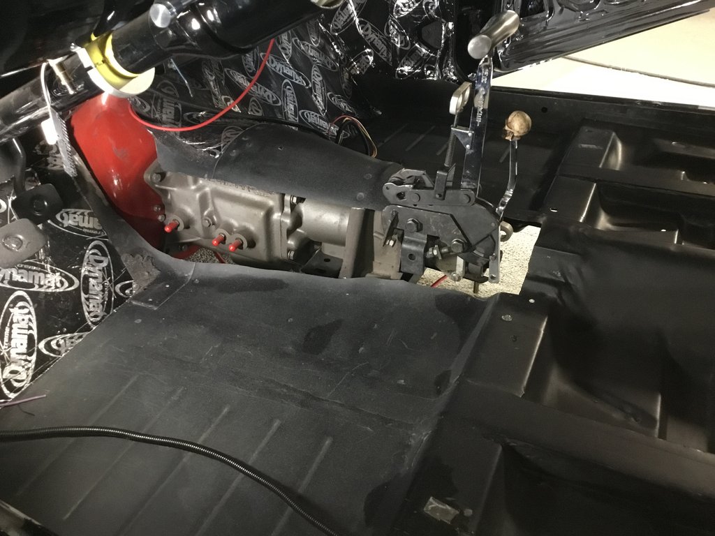

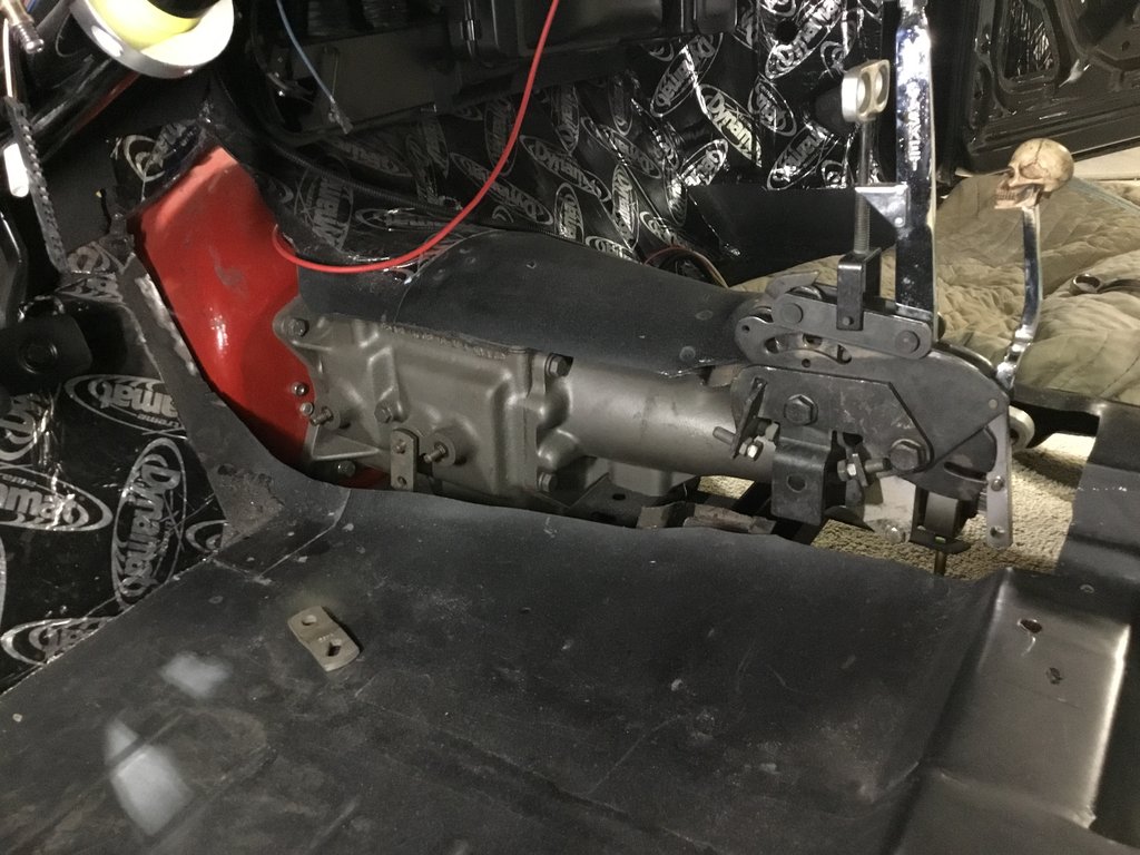

Started on my shifter today. Got it mounted to trans.
Wasn't to hard after cutting a minor hole in the tunnel, lol

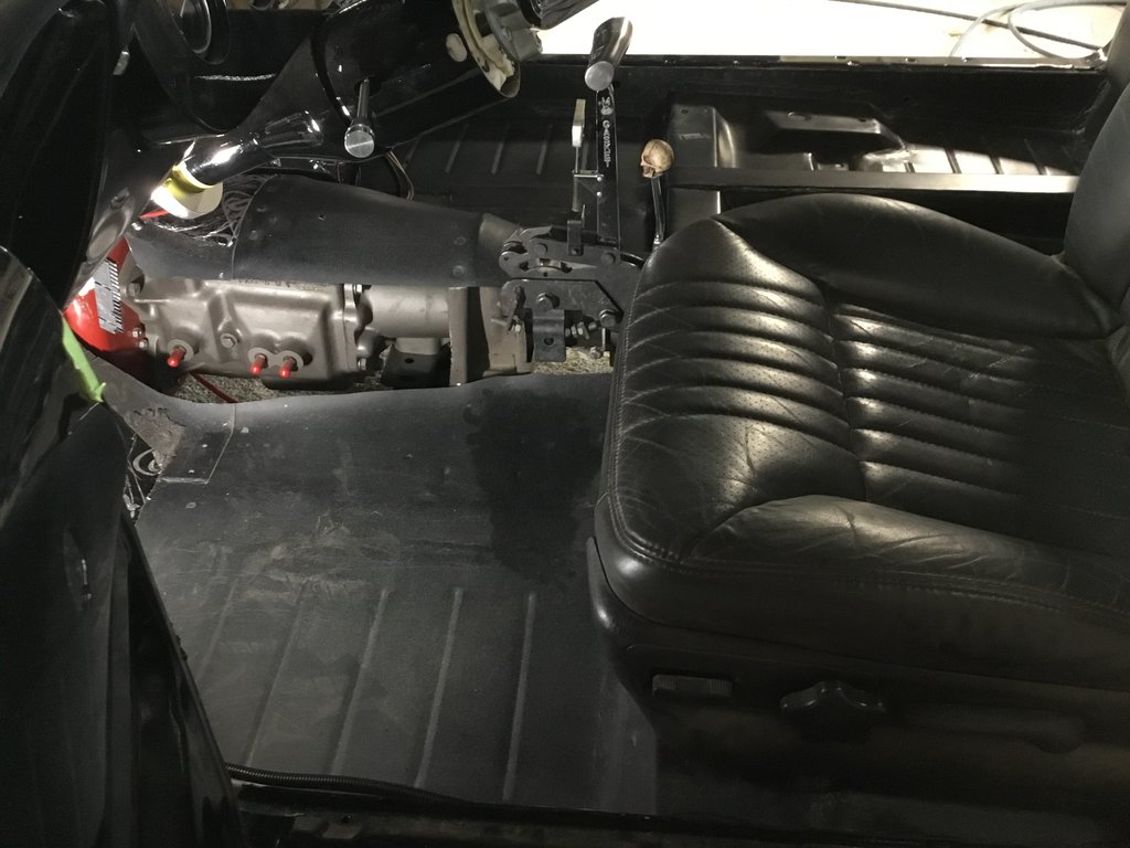

Not going to be able to save the brace, going to have to cut it. But should be extremely easy to make shift linkage after brace is cut. Put the seat in place to see how close it was.
Have plenty of room. Seems like shifter is in a pretty comfortable position.

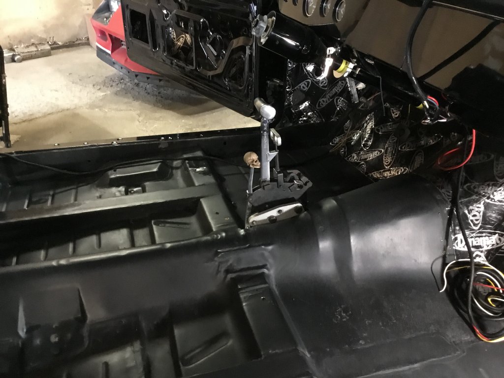

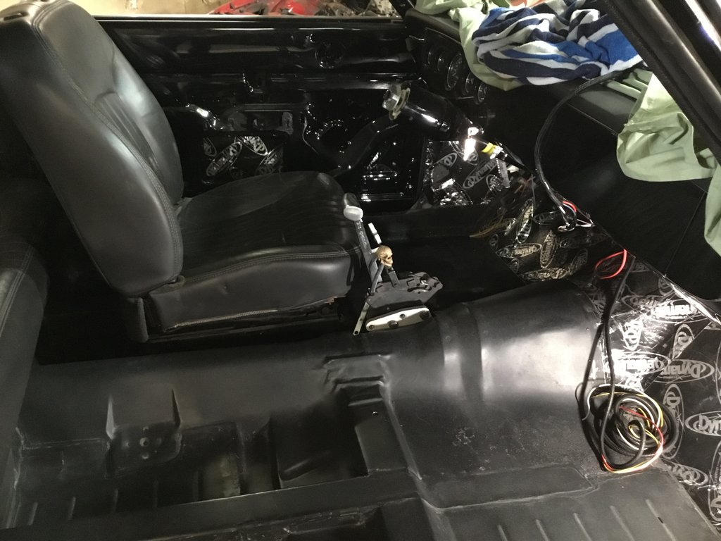

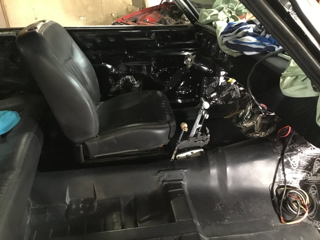

Here are pictures with the shifter in 1st
And 2nd
Going to install steering wheel so I can adjust seat to steering wheel, and check position of shifter again. Thinking it is where I want it. If I need to move it back some the mount has an extra setof mounting holes 2" further back.

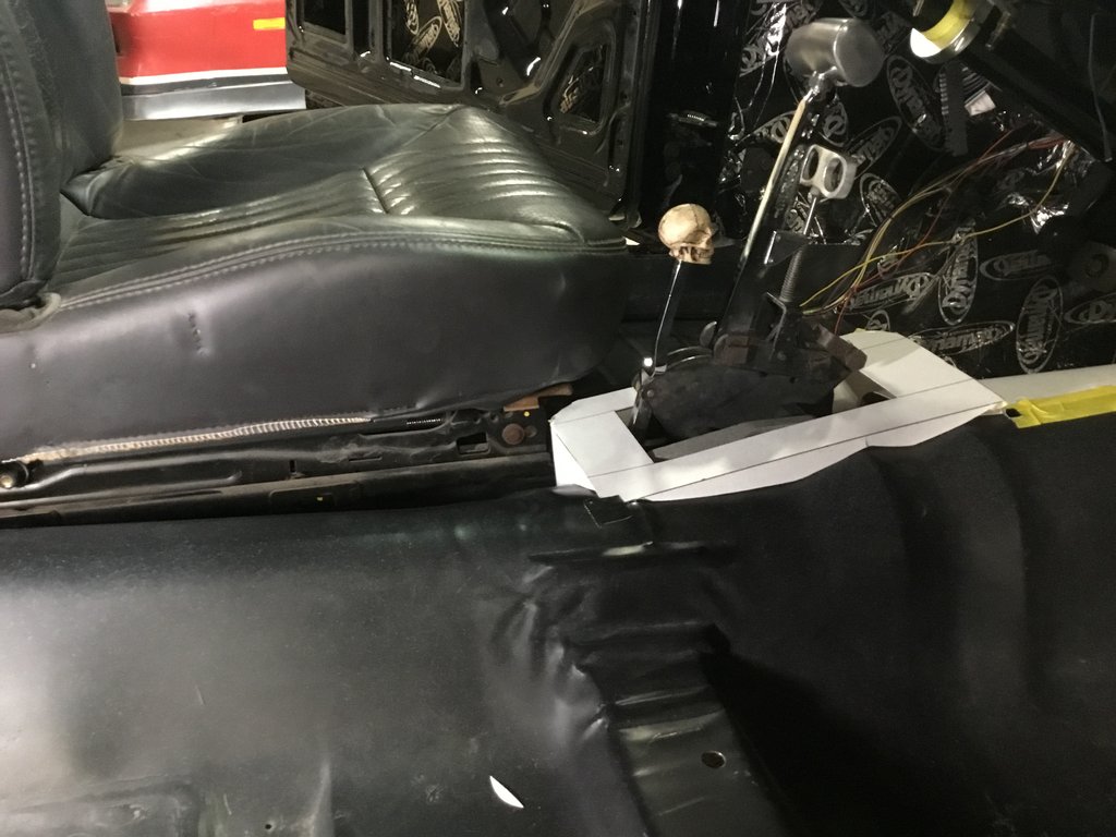

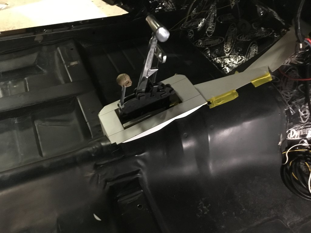

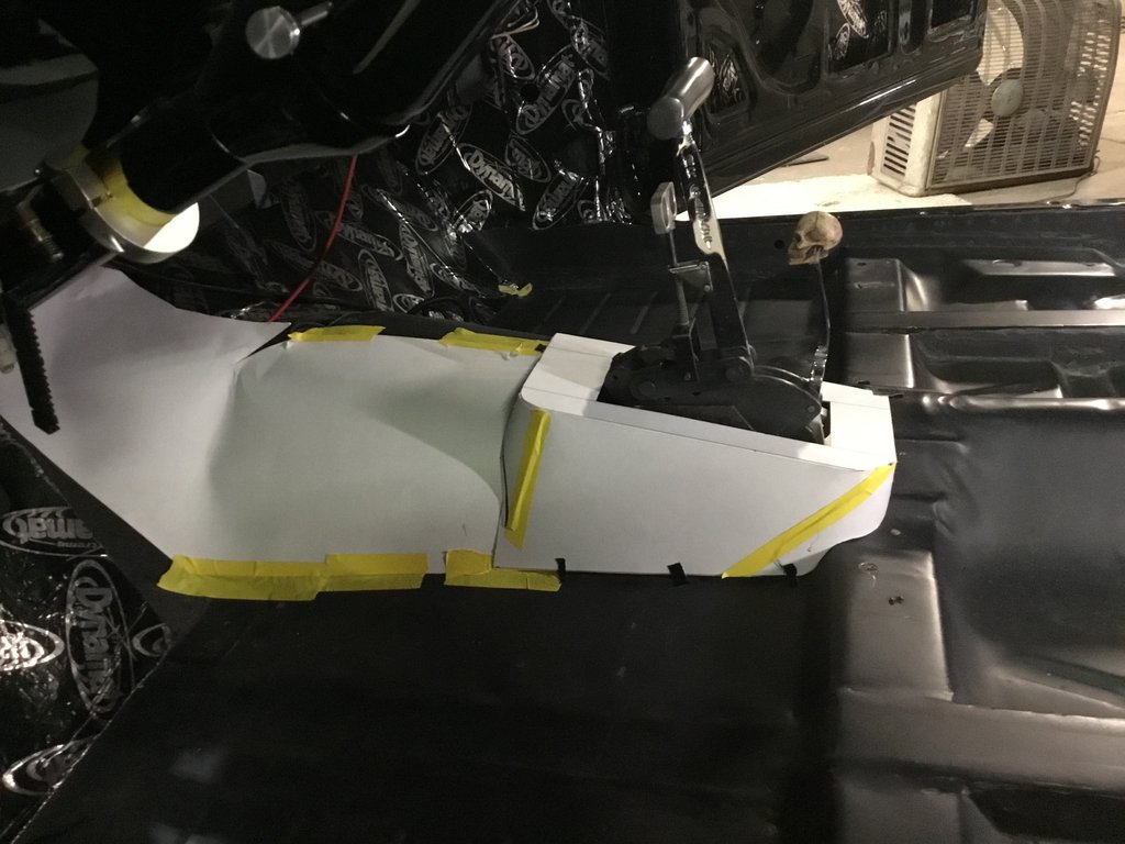

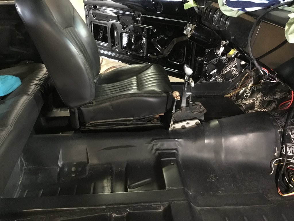

Worked some more on the shifter, I cut the brace out of my way.

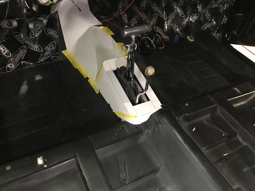

Now I have plenty of room for linkage. I ordered a shifter installation kit with rods I think will work. If not it at least gives me something to start with. While I am waiting for the kit I started working on shifter hump and tunnel piece. Will make them in two pieces. Made some poster board templates to give me a rough idea where everything will fit and what size shifter boot to look for.
Then put the seat in place to make sure everything clears
It is close, but it does all fit. Once I get the linkage all installed I will trim and try to get a little more clearance for shifter hump to seat.

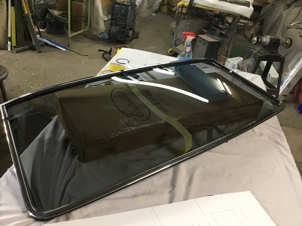

I also polished the rear window trim and got the rear glass ready to install

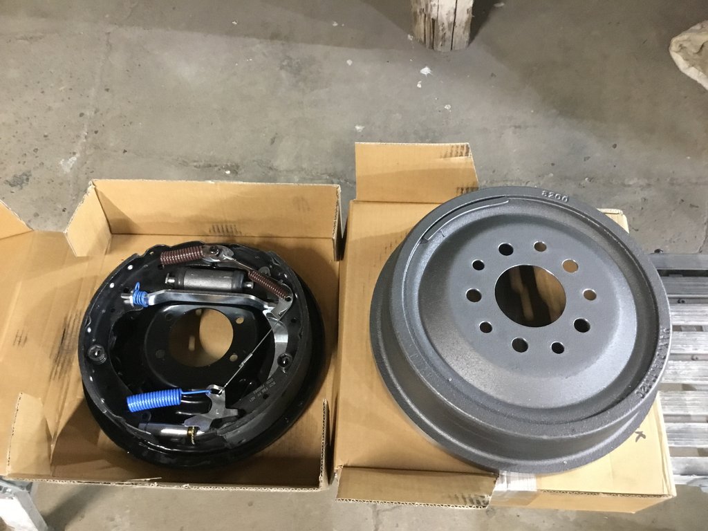

And my rear brake kit came Saturday
Before installing rear brakes need to set pinion angle, weld perches, and paint rear. Then get a driveshaft made.
